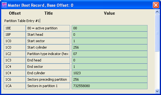

dencorso Posted October 23, 2017 Posted October 23, 2017 6 hours ago, cdob said: XP should work with the 3TB USB drive. No idea about 2000. It actually does work! See: Confirmed - 3TB HDD USB Drive on WinXP 32bit. 6 hours ago, cdob said: Does the USB bridge offers 512 byte or 4 k sectors? Which MBR partition data are available out of the box? Backup the first several sectors. 4KiB sectors. The relevant MBR part is decoded below. A full binary image is get attached to the original post.
98SE Posted October 23, 2017 Posted October 23, 2017 (edited) 10 hours ago, cdob said: Does the USB bridge offers 512 byte or 4 k sectors? Which MBR partition data are available out of the box? Backup the first several sectors. In case of 512 byte sectors: Can you try a 3TB floppy? Hence no MBR (sorry for of topic), a partition sector only. usbstor.sys reads this. XP should work with the 3TB USB drive. No idea about 2000. Can you use a live linux DVD?https://wiki.archlinux.org/index.php/NTFS-3G mkfs.ntfs --force -Q -L "3TB_floppy" /dev/sdX 3TB Floppy? The maximum Floppy disk I'm aware of would be 240MB. There is probably the final capacity for floppy disks since optical discs killed them in cost per capacity. Here I've composed a detailed graphical snapshot of the 8TB drive in operation in Windows XP in all its legacy glory. "www.msfn.org/board/topic/177171-what-a-single-8tb-mbr-hard-disk-drive-looks-like-in-windows-xp/" A more descriptive DOS CHKDSK: The type of the file system is NTFS. Volume label is 98SE 8TB MBR EXTERNAL USB HDD. WARNING! F parameter not specified. Running CHKDSK in read-only mode. CHKDSK is verifying files (stage 1 of 3)... File verification completed. CHKDSK is verifying indexes (stage 2 of 3)... Index verification completed. CHKDSK is verifying security descriptors (stage 3 of 3)... Security descriptor verification completed. Windows found problems with the file system. Run CHKDSK with the /F (fix) option to correct these. 7630874 MB total disk space. 7630652 MB in 16782 files. 13440 KB in 798 indexes. 0 KB in bad sectors. 213888 KB in use by the system. 65536 KB occupied by the log file. 0 KB available on disk. 65536 bytes in each allocation unit. 122093996 total allocation units on disk. 0 allocation units available on disk. U:\> As for a Live Linux DVD not at the moment. Do you have a DOS or Windows equivalent program that would gather the information you're interested in seeing? Edited October 23, 2017 by 98SE
