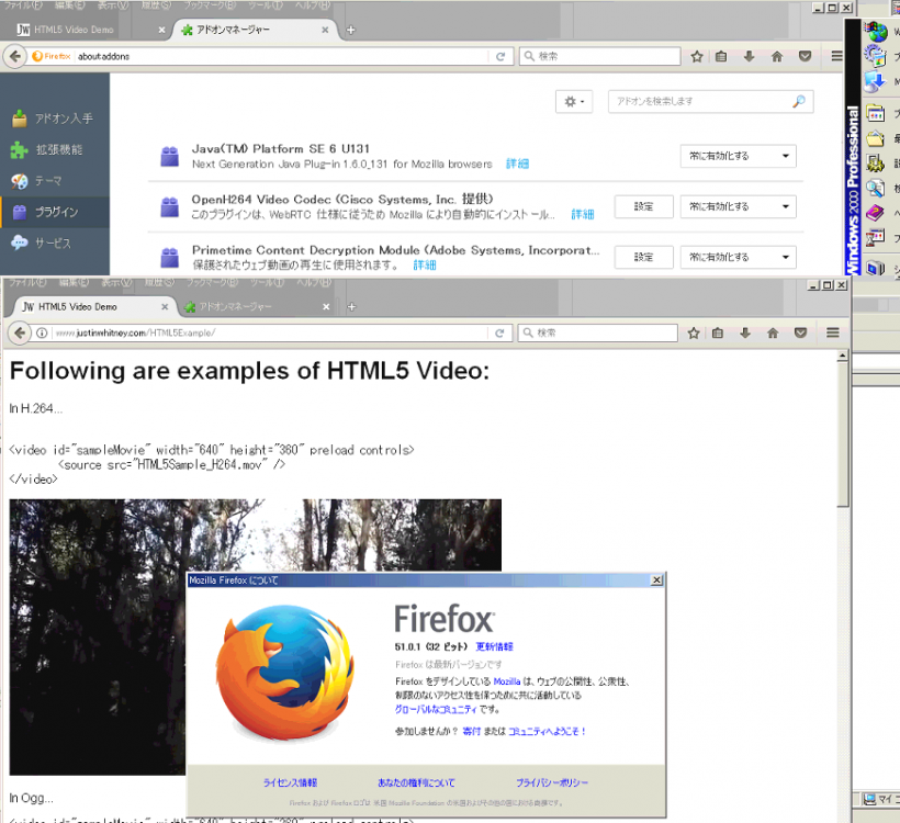

patclash Posted January 26, 2017 Share Posted January 26, 2017 18 hours ago, Bersaglio said: Current release of Firefox is 51.0. I can confirm that it does work fine with Firefox 52.0 Beta-1 on Windows XP SP3 too ! After upgrading my Firefox to 52.0b1 I was forced to re-create 'media.gmp-eme-adobe.enabled' (true) and 'media.gmp-eme-adobe.visible' (true) boolean variables in about:config. Then I restarted my browser and Adobe Primetime PCD got enabled again and MP4 (H.264 + AAC) HTML5 video worked! Voila! Hi , I can confirm after update to 52.0b1 on my XP sp3 , that work fine 1 Link to comment Share on other sites More sharing options...

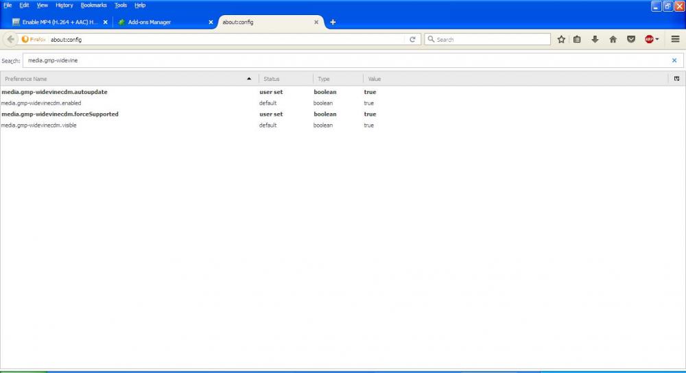

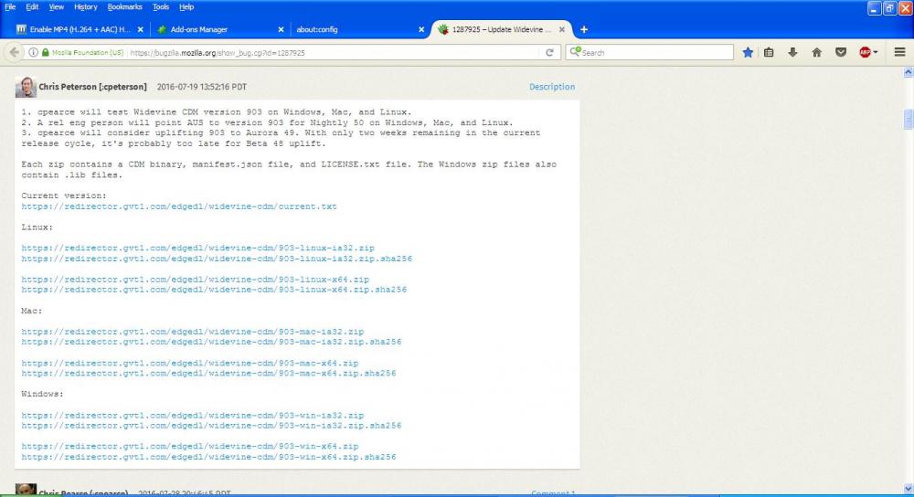

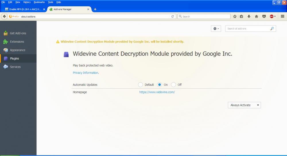

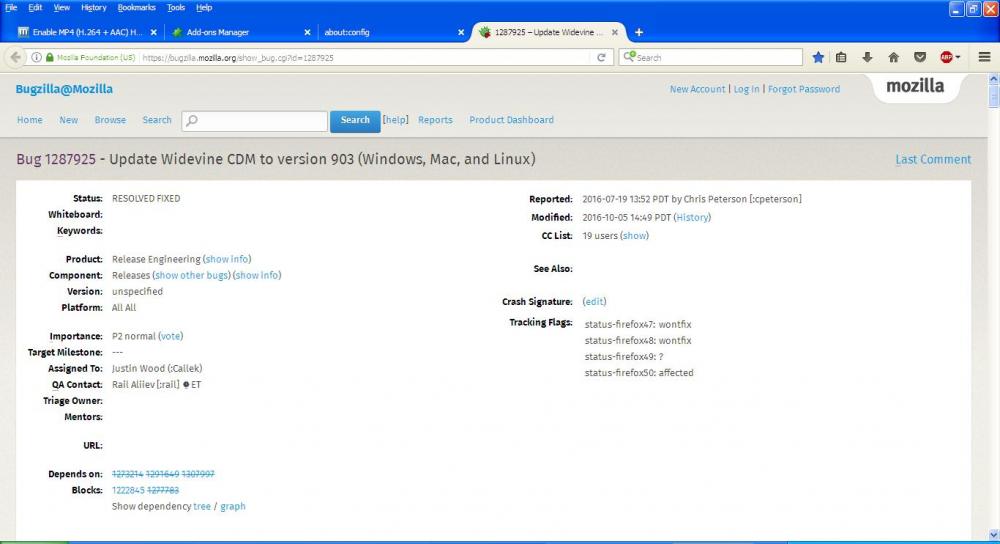

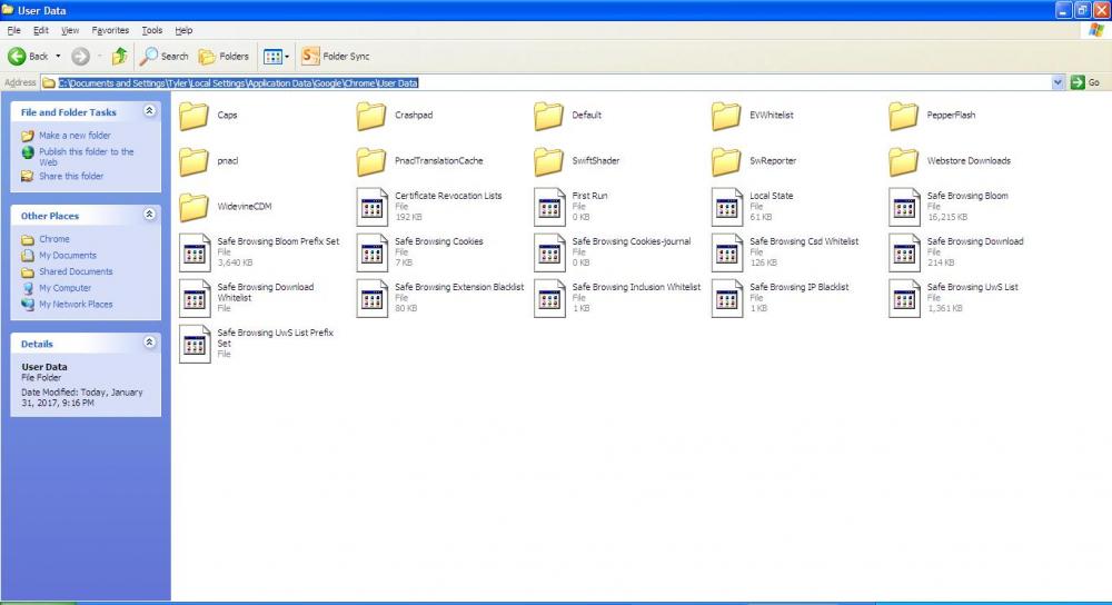

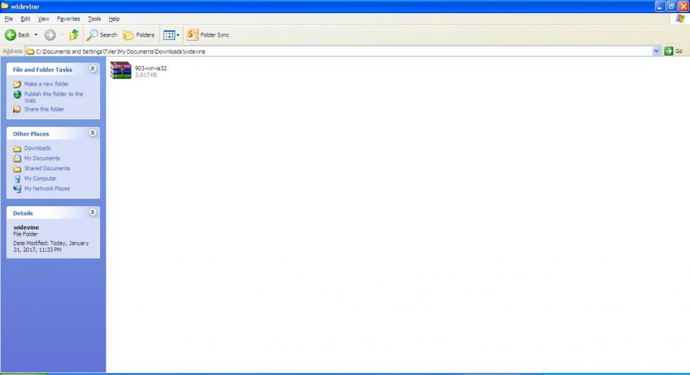

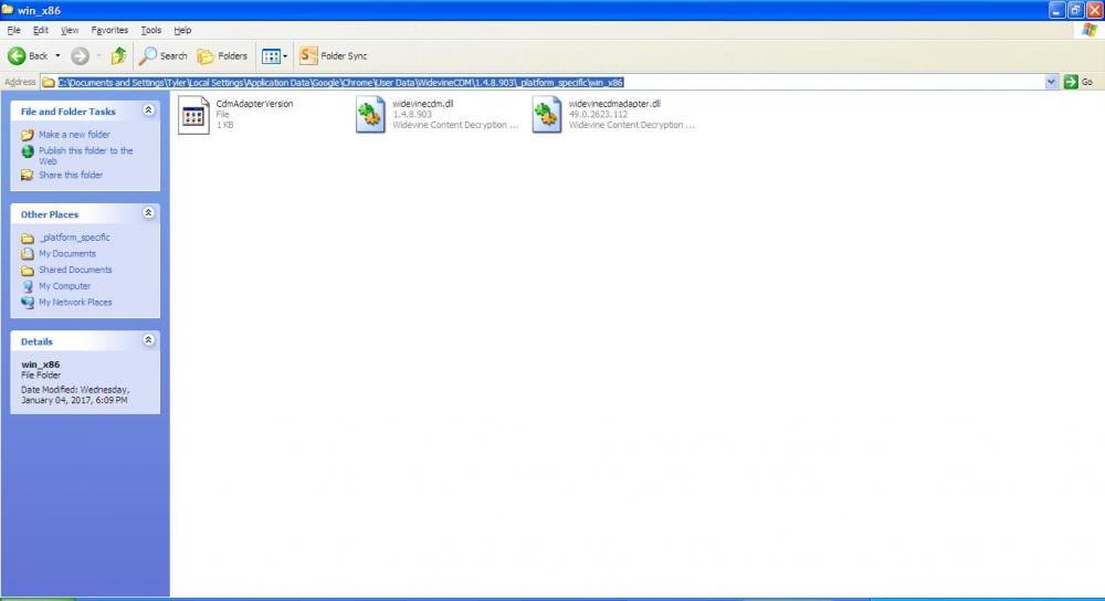

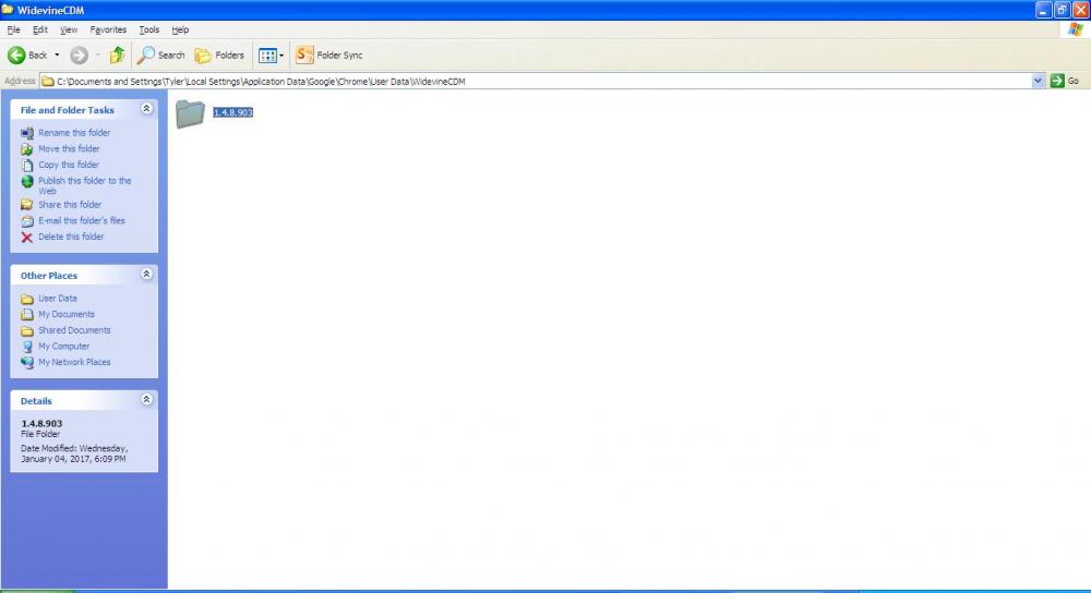

noles20 Posted February 1, 2017 Share Posted February 1, 2017 Although it's not officially supported, I believe it will be possible to use Google Widevine content decryption module in Firefox on Windows XP. This is based on the fact that this plugin works just fine in my chrome 49 install and yes I have updated it to the latest version via chrome://components. Additionally, this belief is even further fueled by the fact that on Mozilla's bugzilla page the same version of widevinecdm.dll (version 1.4.8.903) that my chrome is using is offered to download on this page for Firefox. However, even after manually placing the file in Firefox's profile folder and setting the keys media.gmp-widevinecdm.forceSupported and media.gmp-widevinecdm.visible to enabled in about:config I still can't get the plugin to load. However, I did manage to get widevine to show up in my add-ons manager but it's stuck saying Widevine content decryption module provided by Google Inc. will be installed shortly. However, it never actually does even when I click on check for updates in the manager. Long story short, I was hoping someone in this forum could come up with a solution to install the plugin manually and to test to see if the plugin will load in Firefox on XP. Thus, I have provided the screenshots below to assist someone in helping achieve this goal. 1 Link to comment Share on other sites More sharing options...

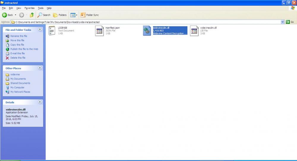

noles20 Posted February 1, 2017 Share Posted February 1, 2017 Here's pictures of the working widevine files that Chrome is relying on. 1 Link to comment Share on other sites More sharing options...
