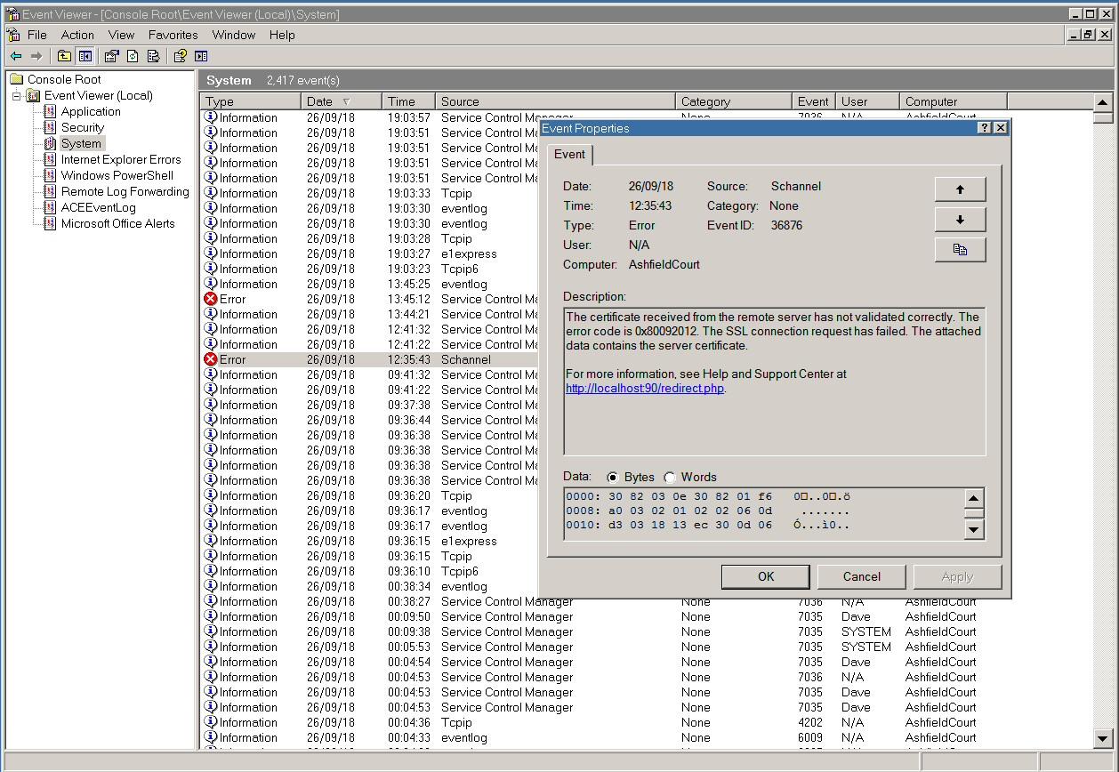

Dave-H Posted September 26, 2018 Posted September 26, 2018 I'm now getting this intermittently in my Windows System log - Is this another certificates problem? The information in the data section of the error means nothing to me I'm afraid! I'm still getting problems in my Eudora e-mail program, despite using the certificate updater and HTTPSProxy. I had an e-mail from Plex the other day about some new offering, and it took literally nearly a minute to open in Eudora! The e-mails from Sky and Marks and Spencer only take about 30 seconds, but that's bad enough. They all look perfect once they're opened, but what could possible be taking so long to resolve when downloading them?!
heinoganda Posted September 27, 2018 Author Posted September 27, 2018 (edited) @Dave-H It would be an advantage if you could find the certificate in the below displayed HEX data, with this error message. The problem is because of the Avast with a certificate with outdated encryption technology for me too, because at Avast the Windows XP support on the technical state of April 2014 has stopped (root certificate with outdated and unsafe encryption technology are still used). This seems to happen when the definition data is updated, which is not a problem because a backup server works with modern encryption technology. For today is once over and will go to sleep. Edited September 27, 2018 by heinoganda
Dave-H Posted September 28, 2018 Posted September 28, 2018 OK, I've found out what's triggering the error message, it happens now every time I run the Opera 36 browser. This is the last version which works on XP. I have sync enabled, and I can only assume that connecting to Opera's servers for this is causing the error message, but I have no idea why.
heinoganda Posted September 28, 2018 Author Posted September 28, 2018 @Dave-H Do you have HTTPS proxy running when using Opera? If so, look for the console of HTTPS Proxy if there are yellow entries in the connections when syncing with Opera.The address (URL) of the yellow entry with the error message is needed (best the complete message) and if necessary an entry must be inserted at the config.ini.
Dave-H Posted September 28, 2018 Posted September 28, 2018 (edited) Yes, this is what I'm seeing in the HTTPSProxy console - [21:31] 000 "[SSL: UNKNOWN_PROTOCOL] unknown protocol (_ssl.c:600)" while trying to establish local SSL tunnel for [push.opera.com:5222] [21:31] 000 "[SSL: UNKNOWN_PROTOCOL] unknown protocol (_ssl.c:600)" while trying to establish local SSL tunnel for [push.opera.com:443] [21:31] 000 "[SSL: WRONG_VERSION_NUMBER] wrong version number (_ssl.c:600)" while trying to establish local SSL tunnel for [autoupdate.geo.opera.com:443] [21:31] 039 [D] "POST https://sync.opera.com/api/sync/command/?client=Opera&client_id=xxxxxxxxxxxxxxxxxx" 200 261 [21:31] 000 "[SSL: WRONG_VERSION_NUMBER] wrong version number (_ssl.c:600)" while trying to establish local SSL tunnel for [autoupdate.geo.opera.com:443] [21:31] 022 ProxHTTPSProxyMII FrontProxy/v1.4 [WinError 10054] An existing connection was forcibly closed by the remote host [21:31] 023 ProxHTTPSProxyMII FrontProxy/v1.4 [WinError 10054] An existing connection was forcibly closed by the remote host [21:31] 000 "[SSL: WRONG_VERSION_NUMBER] wrong version number (_ssl.c:600)" while trying to establish local SSL tunnel for [autoupdate.geo.opera.com:443] [21:31] 000 "[SSL: UNKNOWN_PROTOCOL] unknown protocol (_ssl.c:600)" while trying to establish local SSL tunnel for [push.opera.com:5222] [21:31] 000 "[SSL: UNKNOWN_PROTOCOL] unknown protocol (_ssl.c:600)" while trying to establish local SSL tunnel for [push.opera.com:443] [21:31] 000 "[SSL: WRONG_VERSION_NUMBER] wrong version number (_ssl.c:600)" while trying to establish local SSL tunnel for [autoupdate.geo.opera.com:443] [21:31] 041 [D] "GET https://easylist-downloads.adblockplus.org/easyprivacy.txt?_=1538166666207" 200 123845 [21:31] 040 [D] "GET https://easylist-downloads.adblockplus.org/easylist.txt?_=1538166666206" 200 637620 [21:32] 042 [D] "POST https://autoupdate.geo.opera.com/ 1037" 200 - [21:32] 000 "[SSL: UNKNOWN_PROTOCOL] unknown protocol (_ssl.c:600)" while trying to establish local SSL tunnel for [push.opera.com:5222] [21:32] 000 "[SSL: UNKNOWN_PROTOCOL] unknown protocol (_ssl.c:600)" while trying to establish local SSL tunnel for [push.opera.com:443][21:31] 000 "[SSL: UNKNOWN_PROTOCOL] unknown protocol (_ssl.c:600)" while trying to establish local SSL tunnel for [push.opera.com:5222] [21:31] 000 "[SSL: UNKNOWN_PROTOCOL] unknown protocol (_ssl.c:600)" while trying to establish local SSL tunnel for [push.opera.com:443] [21:31] 000 "[SSL: WRONG_VERSION_NUMBER] wrong version number (_ssl.c:600)" while trying to establish local SSL tunnel for [autoupdate.geo.opera.com:443] [21:31] 039 [D] "POST https://sync.opera.com/api/sync/command/?client=Opera&client_id=xxxxxxxxxxxxxxxxxx" 200 261 [21:31] 000 "[SSL: WRONG_VERSION_NUMBER] wrong version number (_ssl.c:600)" while trying to establish local SSL tunnel for [autoupdate.geo.opera.com:443] [21:31] 022 ProxHTTPSProxyMII FrontProxy/v1.4 [WinError 10054] An existing connection was forcibly closed by the remote host [21:31] 023 ProxHTTPSProxyMII FrontProxy/v1.4 [WinError 10054] An existing connection was forcibly closed by the remote host [21:31] 000 "[SSL: WRONG_VERSION_NUMBER] wrong version number (_ssl.c:600)" while trying to establish local SSL tunnel for [autoupdate.geo.opera.com:443] [21:31] 000 "[SSL: UNKNOWN_PROTOCOL] unknown protocol (_ssl.c:600)" while trying to establish local SSL tunnel for [push.opera.com:5222] [21:31] 000 "[SSL: UNKNOWN_PROTOCOL] unknown protocol (_ssl.c:600)" while trying to establish local SSL tunnel for [push.opera.com:443] [21:31] 000 "[SSL: WRONG_VERSION_NUMBER] wrong version number (_ssl.c:600)" while trying to establish local SSL tunnel for [autoupdate.geo.opera.com:443] [21:31] 041 [D] "GET https://easylist-downloads.adblockplus.org/easyprivacy.txt?_=1538166666207" 200 123845 [21:31] 040 [D] "GET https://easylist-downloads.adblockplus.org/easylist.txt?_=1538166666206" 200 637620 [21:32] 042 [D] "POST https://autoupdate.geo.opera.com/ 1037" 200 - [21:32] 000 "[SSL: UNKNOWN_PROTOCOL] unknown protocol (_ssl.c:600)" while trying to establish local SSL tunnel for [push.opera.com:5222] [21:32] 000 "[SSL: UNKNOWN_PROTOCOL] unknown protocol (_ssl.c:600)" while trying to establish local SSL tunnel for [push.opera.com:443] I guess this is the problem! Edited September 29, 2018 by Dave-H

Mathwiz Posted September 28, 2018 Posted September 28, 2018 1 hour ago, Dave-H said: I guess this is the problem! I'm not so sure - Opera uses schannel.dll to communicate to the proxy server, but the proxy doesn't use schannel.dll to communicate to the outside world. (That's sort of the point.) So unless Opera is bypassing the proxy for some site, the only way you should be getting certificate validation errors from schannel.dll is if the proxy server's own CA.crt certificate isn't installed or trusted.
heinoganda Posted September 28, 2018 Author Posted September 28, 2018 @Dave-H Quit HTTPS Proxy, open the config.ini file in the HTTPS Proxy directory, add the following entries under [SSL Pass-Thru] and start HTTPS Proxy again as usual. *sync.opera.com* *autoupdate.geo.opera.com* Check if the error messages on the console of HTTPS Proxy still exist and if the error still occurs under Windows system log.
Dave-H Posted September 28, 2018 Posted September 28, 2018 Thanks, I added those entries and the error messages are gone! This is what I'm seeing now in HTTPSProxy - [23:28] 000 "[SSL: UNKNOWN_PROTOCOL] unknown protocol (_ssl.c:600)" while trying to establish local SSL tunnel for [push.opera.com:5222] [23:28] 000 "[SSL: UNKNOWN_PROTOCOL] unknown protocol (_ssl.c:600)" while trying to establish local SSL tunnel for [push.opera.com:443] [23:28] 003 [D] "GET https://news.google.com/news?q={searchTerms}&sourceid=opera&num=%i&ie=utf-8&oe=utf-8" 301 0 [23:28] 002 [D] "GET https://www.google.com/search?q={searchTerms}&sourceid=opera&num=%i&ie=utf-8&oe=utf-8" 302 315 [23:28] 001 [D] "GET https://www.google.com/search?q={searchTerms}&sourceid=opera&ie=utf-8&oe=utf-8&channel=suggest" 302 324 [23:28] 007 [D] "GET https://news.google.com/search?q=%7BsearchTerms%7D&sourceid=opera&num=%25i&ie=utf-8&oe=utf-8" 302 0 [23:28] 006 [D] "GET https://search.opera.com/?search={searchTerms}&global=no" 302 262 [23:28] 008 [D] "GET https://www.google.com/search?client=opera&q={searchTerms}&sourceid=opera&num=%i&ie=utf-8&oe=utf-8" 200 - [23:28] 009 [D] "GET https://www.google.com/search?client=opera&q={searchTerms}&sourceid=opera&ie=utf-8&oe=utf-8&channel=suggest" 200 - [23:28] 005 [D] "GET https://www.amazon.com/s/145-7872646-0478402?ie=UTF8&index=blended&keywords=%7BsearchTerms%7D&link_code=qs&tag=opera-20" 200 - [23:28] 010 [D] "GET https://www.google.com/sdch/4orahf3u.dct" 200 - [23:28] 010 ProxHTTPSProxyMII FrontProxy/v1.4 [WinError 10053] An established connection was aborted by the software in your host machine [23:28] 000 [D] SSL Pass-Thru: https://sync.opera.com:443/ [23:28] 004 [D] "GET https://com.com/" 200 - [23:28] 012 [D] "OPTIONS https://plex.tv/pms/:/ip None" 200 0 [23:28] 014 [D] "GET https://plex.tv/pms/:/ip" 200 15 [23:28] 013 [R][D] "GET https://plex.r.worldssl.net/announcements/announcements.json?cb=1538173710824" HTTPSConnectionPool(host='plex.r.worldssl.net', port=443): Max retries exceeded with url: /announcements/announcements.json?cb=1538173710824 (Caused by NewConnectionError('<urllib3.connection.VerifiedHTTPSConnection object at 0x03772FB0>: Failed to establish a new connection: [Errno 11001] getaddrinfo failed',)) [23:28] 011 [D] "GET https://search.yahoo.com/yhs/search?hspart=Opera&hsimp=yhs-international&p=%7BsearchTerms%7D" 200 - [23:28] 000 [D] SSL Pass-Thru: https://www.google-analytics.com:443/ [23:28] 000 [D] SSL Pass-Thru: https://www.google-analytics.com:443/ [23:28] 000 [D] SSL Pass-Thru: https://www.google-analytics.com:443/ [23:28] 007 [D] "GET https://news.google.com/search?q=%7BsearchTerms%7D&sourceid=opera&num=%25i&ie=utf-8&oe=utf-8" 302 0 [23:28] 015 [D] "GET https://news.google.com/search?q=%7BsearchTerms%7D&sourceid=opera&num=%25i&ie=utf-8&oe=utf-8&hl=en-GB&gl=GB&ceid=GB:en" 200 - [23:28] 015 ProxHTTPSProxyMII RearProxy/v1.4 [WinError 10053] An established connection was aborted by the software in your host machine [23:28] 016 [D] "GET https://search.yahoo.com/favicon.ico" 304 - [23:28] 015 [D] "GET https://news.google.com/search?q=%7BsearchTerms%7D&sourceid=opera&num=%25i&ie=utf-8&oe=utf-8&hl=en-GB&gl=GB&ceid=GB:en" 200 - [23:28] 000 [D] SSL Pass-Thru: https://autoupdate.geo.opera.com:443/ [23:28] 000 "[SSL: UNKNOWN_PROTOCOL] unknown protocol (_ssl.c:600)" while trying to establish local SSL tunnel for [push.opera.com:5222] [23:28] 000 "[SSL: UNKNOWN_PROTOCOL] unknown protocol (_ssl.c:600)" while trying to establish local SSL tunnel for [push.opera.com:443] Still some apparent errors there, but nothing in the Windows logs. Cheers, Dave.
heinoganda Posted September 29, 2018 Author Posted September 29, 2018 (edited) @Dave-H An error is still at the beginning and end to see again in the HTTPS proxy console, open the config.ini file in the HTTPS proxy directory, add the following entrie under [SSL pass-thru] and start HTTPS proxy again as usual. *push.opera.com* The next coming update of HTTPS Proxy will apply these entries. If you have such yellow error messages on certain web pages you can communicate them via PM. Otherwise, only Windows system log remains to see if this error still occurs. Edited September 29, 2018 by heinoganda
