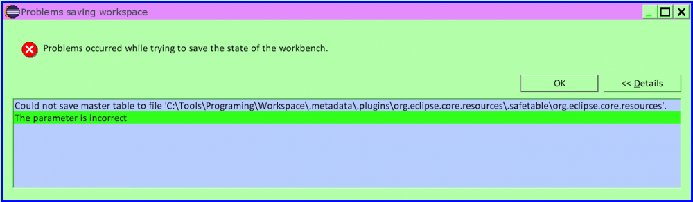

The other problem which may not be a KernelEx one but is important is the assigning of folders like .folder in Java 1.7 and above. I think Java has a problem finding the correct folders. Some programs I have that use Java are VUZE 5.4; Art of Illusion vs 3.1; and Eclipse Luna 2014. It is important as saving of work in Eclipse can not be done properly and Vuze always wants to install the Swt download in an incorrect location or something like it. Edit: The assigning of folders like .folder in Java 1.7 and above happens with other NT operating systems; it puts a full stop in front of the folder and places it in a parent folder.
I am still looking into this issue but would appreciate help. Eclipse is storing in correct location but 0 kB, see picture.
