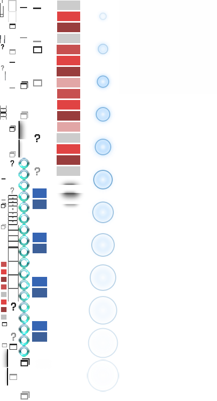

I was looking at that result and I was thinking maybe the caption button tops could be cut down 1 pixel and not interfere with that light border. I haven't the time tonight but I'll look at it tomorrow. Would you think that would be a visual improvement? I'm not using that theme atlas on any system myself, so it's hard to judge. If there's interest, I'll try making up a copy tomorrow with shorter caption buttons.
-Noel
It sounds promising, NoelC! This atlas is beatufiul already but this trick can make it even better!
Would it be too cocky to ask you to take a look at atlas that i use with my win10 system, in order to make it look more flat-like(if it's possible of course)?

I fooled around with the atlas file quite a bit and was able to get the start menu to be border-less. The windows also look pretty good.

I've made some tweaks to my Atlas theme and since everything seems to look and function like I want, I thought why not to share it so you can try it out if you like!
Layout file is also attached in the zip, because I made some modifications to the button margins and messed with the image positions a bit. :P
http://hrtlan.com/theme_preview.jpg

Uploaded another update to make the button symbols appear more shaded and tweaked all the button symbols once for all. So nothing big really, but I felt that I had to adjust those symbols because they look better this way. Maybe I'll tweak the windows shadows in the future...

To apply themeatlas.png you use aeroglassgui.  Your themeatlas should have a layout file associated with it WITH THE SAME NAME EXCEPT FOR LAYOUT AT THE END.  In otherwords testatlas.png would associate with testatlas.png.layout.  You open the layout file in notepad and add CaptionHeight=12 to the end.  You can change the end number to your preference.
While it doesn't look too distracting, you idea sounds good, the captions could be tweaked down a touch.
I tried cutting a single row of pixels off the top of each of the caption button fills. I'm out of time and can't test it myself just now, though... See how this works for you...
http://Noel.ProDigitalSoftware.com/ForumPosts/Win8/Win8RTM_With_CP_Borders3.png
-Noel
NoelC, thanks for your time, here is the result that i get:
http://postimg.org/image/akfnky63z/
