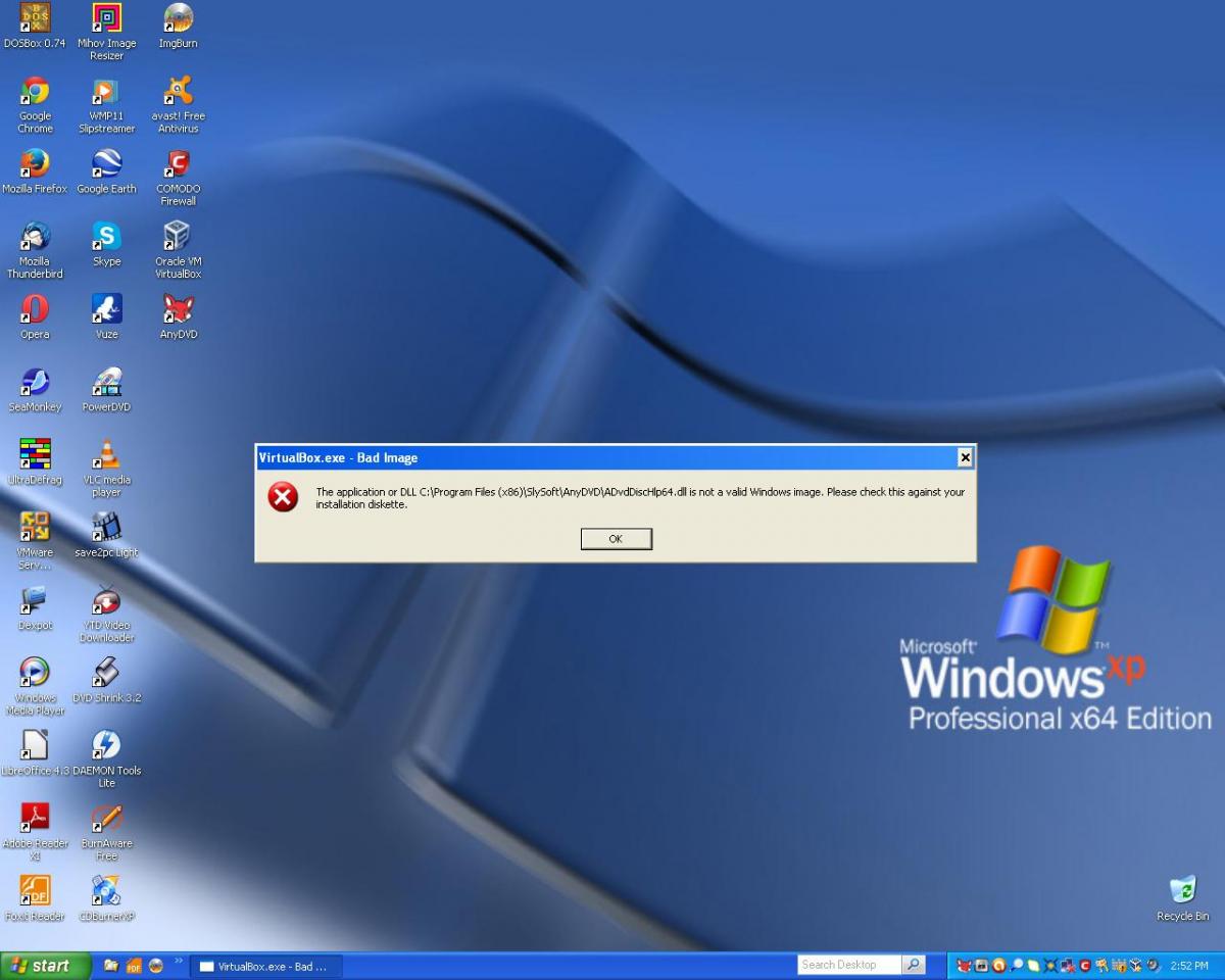

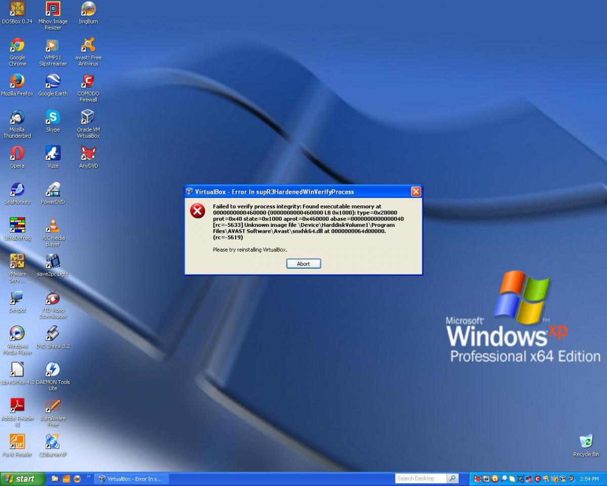

The latest version of VirtualBox (4.3.14) has a major dll injection bug (main forum post has 440+ comments), in my case launching it results in the attached errors so stick with 4.3.12 for now.
post-137148-0-34496900-1408157470_thumb.post-137148-0-04003900-1408157858_thumb.

I normally create a test install media the weekend before patch Tuesday just to test for incompatibilities in the newly released versions of the supported applications.
That's when I came across the problem with VirtualBox, in trying to diagnose it I also found that if one uninstalls Slysoft's AnyDVD all of one's DVD drives disappear (yellow icon in device manager) - since reported and fixed.
