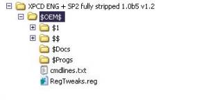

Fridge-RaideR Posted August 2, 2005 Author Share Posted August 2, 2005 (edited) well more like Pro's with problems newbies should stick with nLite (no offence people, but this if u do this, ur bound to experience loads of errors)and I think dirtwarrior wants to see the oemfolder and thats pretty much it... it isnt bigger.. I manually do my cleanup, dont have extra programs, dont use minlogon Edited August 2, 2005 by Fridge-RaideR Link to comment Share on other sites More sharing options...
dirtwarrior Posted August 2, 2005 Share Posted August 2, 2005 hey fridge post $oem$ folder and last session ini Cool Link to comment Share on other sites More sharing options...
Fridge-RaideR Posted August 2, 2005 Author Share Posted August 2, 2005 lastsession.ini is in first postoemfolder is in post 6theme is in attachment 2, and those 2 links of image shack work Link to comment Share on other sites More sharing options...
