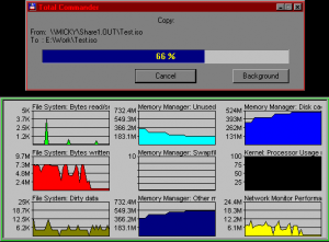

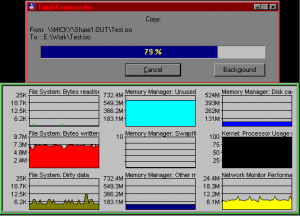

MDGX, remember my old problem left unsolved?
Did anybody notice a decrease of speed when copying large files from network after installing 98SE2ME?
This week I reinstalled Windows. After installing 98SE2ME, the problem was back. This time I investigated the problem. It's not related to network, but to windows disk cache.
When I copy files from network (shared on Windows XP, one switch between computers) tranfer rate drops when the disk cache is full.
See the atached images:
First image = Disk cache set to 512MB - network tranfer and disk write speed drops
Second image = Disk cache set to 64MB - network transfer and disk write speed remains high
Replacing VCACHE.VXD v4.90.3000 with default Win98 version solved the problem.
