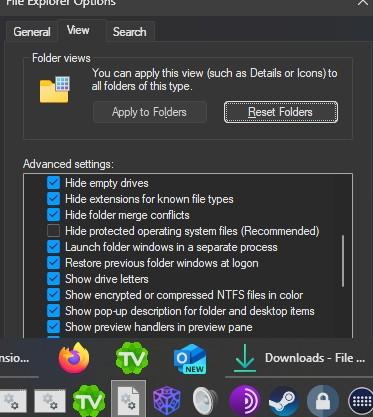

Tihiy Posted July 27, 2024 Author Posted July 27, 2024 (edited) 8 hours ago, Onilink said: The taskbar will no longer appear on the desktop when trying to hover over it only on the primary monitor. It does open as long as a window is opened in the foreground and not minimized. Now this would happen if fullscreen window is detected. Do you use GeForce Experience Overlay? Does https://github.com/dechamps/RudeWindowFixer fix the issue? 3 hours ago, SESNut said: will tooltips be added to toolbar icons? Not sure what you mean, tooltips are there. They won't be shown if you have 'Show pop-up description for folder and desktop items' explorer setting disabled. Edited July 27, 2024 by Tihiy

SESNut Posted July 27, 2024 Posted July 27, 2024 (edited) 10 hours ago, Tihiy said: Now this would happen if fullscreen window is detected. Do you use GeForce Experience Overlay? Does https://github.com/dechamps/RudeWindowFixer fix the issue? Not sure what you mean, tooltips are there. They won't be shown if you have 'Show pop-up description for folder and desktop items' explorer setting disabled. I have it enabled; ive never had it off. I tried turning it off and on, no change. Theres no tooltup showing the name of the shortcut when mouse is over it Edited July 27, 2024 by SESNut
