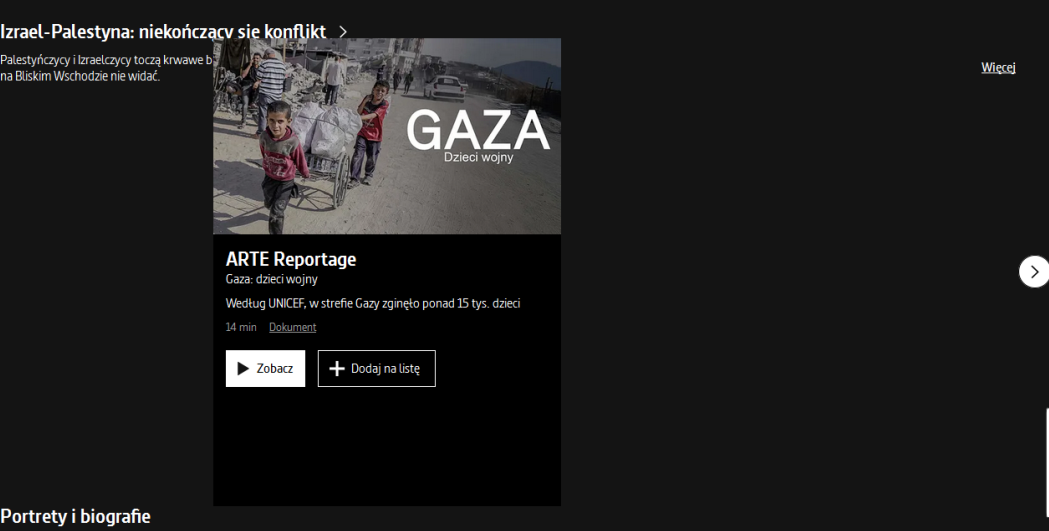

VistaLover Posted July 30, 2025 Posted July 30, 2025 7 hours ago, covo said: and now... NM doesn't work: http://arte.tv - UA change does not improve the situation... What version of New Moon? What SSUAO in use? In what way does the site NOT work for you? I'm currently using: general.useragent.override.arte.tv;Mozilla/5.0 (Windows NT 10.0; rv:128.0) Gecko/20100101 Firefox/128.0 and a very old by now NM28 (v28.10.7a1, 32-bit, 2024-09-06) has no issues here, both loading the site AND playing back videos: 1
covo Posted July 30, 2025 Posted July 30, 2025 3 hours ago, VistaLover said: What version of New Moon? What SSUAO in use? In what way does the site NOT work for you? 1/ the last v. of NM 2/ UA --> Mozilla/5.0 (Windows NT 10.0; Win64; x64; rv:130.0) Gecko/20100101 Firefox/130.0 3/ it "shows" the graphics terribly: https://postimg.cc/9zMH48dJ, & the graphics are shown at the cursor stop: https://postimg.cc/TpfmqbP7, https://i.postimg.cc/tR8cFgX9/screenshot.png (and: when you can see the graphics/photo and player arrow somewhere - you can watch video) The second link: https://postimg.cc/nMyx6Km2
