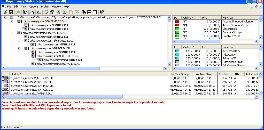

UCyborg Posted October 23, 2023 Share Posted October 23, 2023 (edited) Specifically, WidevineCdm folder taken from fresh install of latest Windows 7 compatible 32-bit Chrome 109 and put into 360Chrome's "components" folder as "widevine12" will work, at least it should on Windows 7+ at the time of this writing. Don't have ready Win7 install anywhere, but it worked on 10. I also tried period correct Widevine version from Chrome 86, this one does not work anymore, got SOURCE_ERROR on https://bitmovin.com/demos/drm. Edited October 23, 2023 by UCyborg Link to comment Share on other sites More sharing options...
seven4ever Posted October 24, 2023 Share Posted October 24, 2023 (edited) Did not work here under xp 64 on your test site, same SOURCE_ERROR . As 360 chrome is portable, i've lunch it under seven x64, and it works perfectly, same as chrome 109. With dependency walker, i'll see this under Xp64 : Pehaps an older one is working for Xp, but I'm not sure. Version is 4.10.2557.0. Under Linux up to date, Firefox and Kodi have version 4.10.2710.0 Minibrowser is still working, but I don't find the widevine dll from it Edited October 24, 2023 by seven4ever Link to comment Share on other sites More sharing options...
