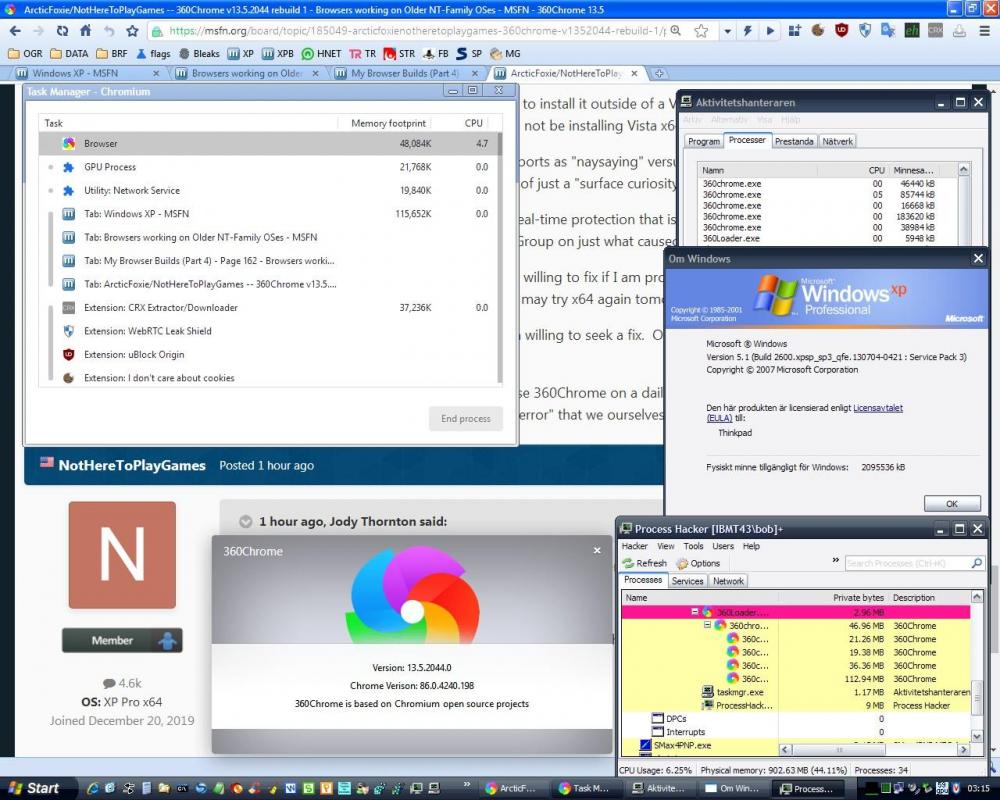

Skorpios Posted October 15, 2023 Posted October 15, 2023 Ver 2044 working quite OK on my cr@ppy Thinkpad T43 with XP Pro SP3 and 2 GB RAM. Added to 360loader.ini: --ssl-version-min=tls1.2 --process-per-site --renderer-process-limit=2 --disable-infobars ===== Flags enabled via GUI: (maybe a security risk, I don't know, I don't care...) Experimental Extension APIs Experimental JavaScript Experimental WebAssembly Future V8 VM features Experimental Web Platform features ===== Plugins disabled: Chromium PDF Viewer Chromium PDF Plugin Native Client Shockwave Flash ===== Rebased with an error but have been browsing around for hours without chrashing or any error message. "C:\unpack>delcert chrome.dll Target file(s): chrome.dll Stripping file: C:\unpack\chrome.dll. Succeeded. C:\unpack>libase chrome.dll LIBASE: module "CHROME.DLL" rebased from 0x10000000 to 0x62a00000 NOTE: size (0x07560000) exceeds base separation (0x00100000)" ===== Gmail OK Protonmal quick login but extremely sloooooow opening of the Inbox and no error messages (only 2 mails sitting there) Scanned with Kasperskys Tool, found processhacker... McAfee Enterprise running most of the time. Thank you NHTPG!

NotHereToPlayGames Posted October 15, 2023 Author Posted October 15, 2023 6 hours ago, Skorpios said: found processhacker... This is a legit concern, to be perfectly honest. It is also a very highly discussed false positive on several real-time protection forums (I found it on Kaspersky, Symantec, TrendMicro, and BitDefender discussion boards). Apparently, even Windows' own Task Manager is also one of these false positives. That said, being false positive or not, this would prevent me from running build 2044 at work. I have been running build 2036 at work for quite some time, so I have to assume it does not have this false positive or Global IT would have sent me a "nastygram" asking if this program is "work-related".
