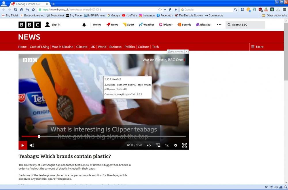

NotHereToPlayGames Posted August 18, 2023 Author Posted August 18, 2023 Just now, Dixel said: CO.UK also works fine for me!! You're only showing the player's "start screen", does the video also PLAY for you?
Dixel Posted August 18, 2023 Posted August 18, 2023 3 hours ago, NotHereToPlayGames said: You're only showing the player's "start screen", does the video also PLAY for you? Of course it does! If the player doesn't work , it shows blank black page without play arrow button, also without the length of the video, like on his original screen. 3

Dixel Posted August 19, 2023 Posted August 19, 2023 3 hours ago, NotHereToPlayGames said: Ah, I'll take your word for it. No need. Now better? 4
