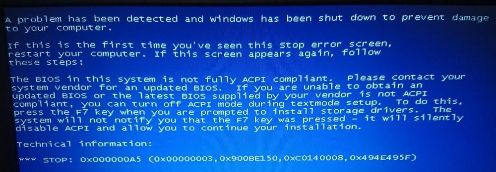

I got this error on a Dell Inspiron 15 3542 laptop with Haswell, even with modded ACPI. The ACPI.sys I tried was given to me by K4sum1, and I know it works properly, as I've used this successfully on my Acer Aspire A315-21 (long gone). The BIOS is American MegaTrends APTIO Setup Utility. UEFI is disabled, Fastboot is disabled, USB is plugged into USB2 port... I know XP works perfectly on Haswell as I've gotten it to install with no ACPI mods needed on my long-gone Inspiron 3847 desktop tower (I'm wondering if a few of those were originally made with Ivy Bridge before they stuck Haswell in them. I know they have a few with AMD inside).

I just tried it and I got the same BSOD. I'm booting an installer and I replaced ACPI.SY_

looking the first page it says it has that 0xA5 error maybe not the exact code
do you maybe got the test for 32 bit ? to me it seems the list of error codes seem to be less for 32 bits

PS: I find also the reason for this Bsod: C0140008 but I cant locate the exact place, where it happens:
ValidateArgTypes or CreateField or ObjTypeSizeOf.
This is a really evil Bsod. Maybe idea for hack from Skull is better
- 0xA5(0x03, ..., C0140008, ...) DSDT code have operation with unexpected type of arguments, partially solved
    This BSOD probably means some argument has datatype, allowed only in ACPI 2.0
