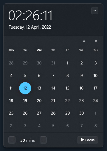

@Tihiy, I already seemed to ask, but if not..
Any way to return the big clock to the calendar flyout window?
I know that this can be done by switching to Windows 10 flyout style, but then it comes with Win 10 outdated design, which I do not like and it spoils everything..
Not that the clock in there is crucial or anything, it's just something I prefer.
Feels a bit empty without it..
tia
tia
Calendar Flyout is a solution.
