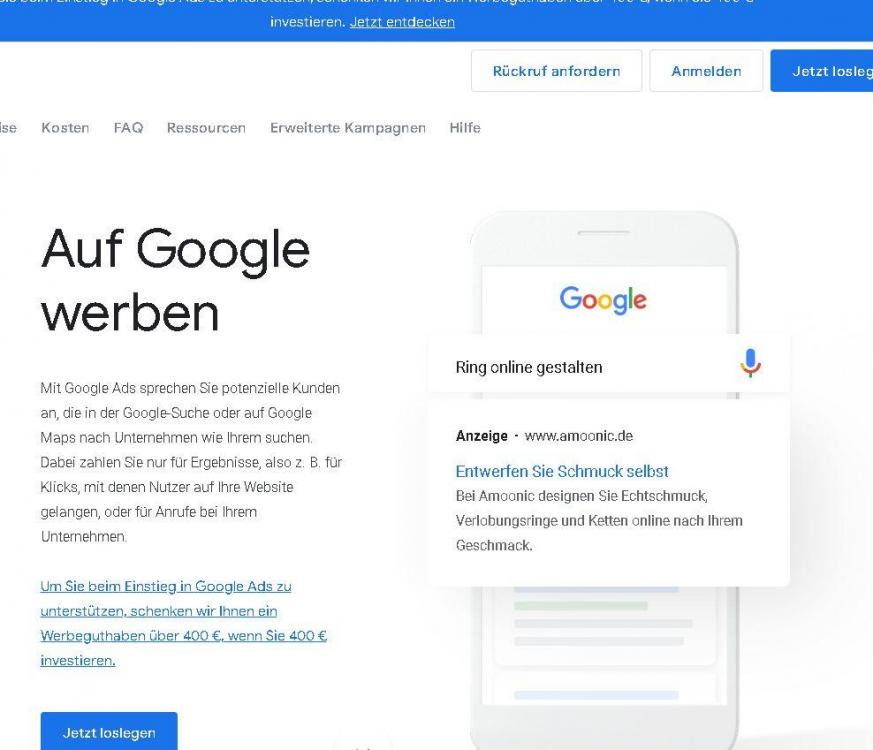

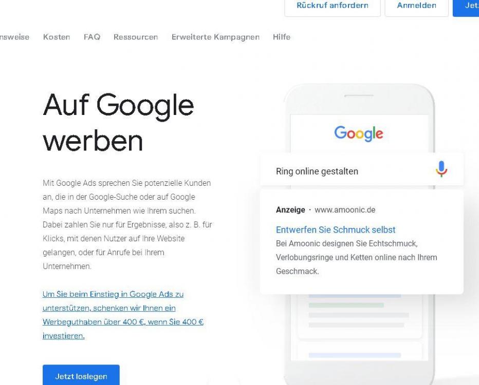

Anbima Posted April 25, 2022 Posted April 25, 2022 (edited) Regarding the letter I had already written. Here is a difference between V13.5 and V11. In V11, the writing is much better. V13.5: V11: Edited April 25, 2022 by Anbima
