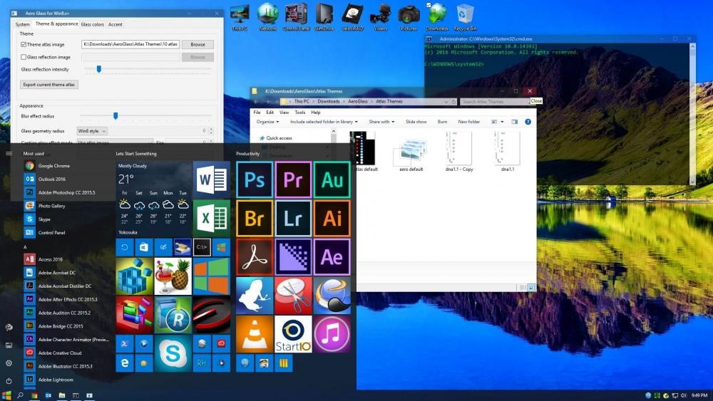

I just wanted to say THANK YOU to bigmuscle and to anyone who gave feedback to keep AeroGlass going.  I'm currently using AeroGlass 1.5 along with the new GUI, a modified default atlas on Windows V.1607 B.14393.223 and everything looks spot on.
