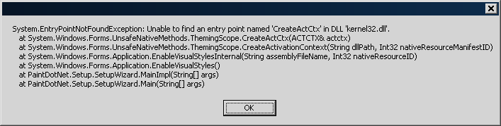

I gave up on 3.5.5 and reverted back to 2.72, but when I ran the installer I got this:
I've EZ Installed kernel32 to the specified directory, but it still doesn't work.
Could you please translate the PDN installation guide to English?
  • Author
I looked at install Paint.Net 3.5.5 installer.
It was made with VS2010, and fail to install.
You had better try to install 3.5.4.
I'll seek how to install 3.5.5.

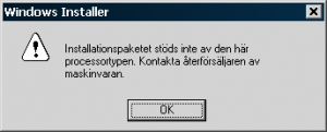

Extracted the files manually with 7-zip, and tried to run the file PaintDotNet.msi in the folder $_OUTDIR. It resulted in this error message:
Translated to english:
This installation package is not supported by this CPU type. Please contact the hardware reseller.
CPU: Intel Celeron III Tualatin 1200 Mhz.
