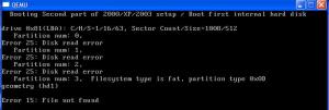

This was my first try with the GUI (1.0 Beta 6). I made an nLited copy of XP (470MB) and got a TakeMS 512MB USB, The size was 483MB, but after RMprepUSB it became 478MB. Formatted it into FAT32 without the option to boot as HDD, pointed to the XP folder and added QEMU for testing. It took a while (over 30 min.) to copy, but that's not really important.
When QEMU started,I got the option to start PLoP or XP install (chose #2) and this screen appeared
post-236786-051024600 1285892625_thumb.j
I chose "First part of setup" and got this
post-236786-060980200 1285892630_thumb.j
I also opened "Second part of setup" and PLoP, but didn't see anything useful. What confuses me is that XPpSP3.ISO line, since I didn't find any.
What am I doing wrong?
Thanks
  • Author
Does the file /winsetup/XPpSP3.ISO exist on the USB stick?
Can you zip and attach WinSetupFromUSB.log file from program directory?
I meant there is no XPpSP3.ISO on the USB key. From what I saw in the log, XPpSP3.ISO is created in the TEMP folder.
Here's the log
WinSetupFromUSB.7z
and this is the screenshot if I choose "Second part of setup"
post-236786-064331400 1285923316_thumb.j
  • Author
:wacko: Where did it go?
It's created in program's temp folder and copied to /winsetup/ folder on the USB stick. But was it created and was it copied...? :whistle:
Such case hasn't been reported yet.
Try to run the program again, watch temp folder if the ISO file is created, next watch if it's copied to /winsetup/ folder on the USB stick.
Use NTFS, file copy speed will be much faster.
