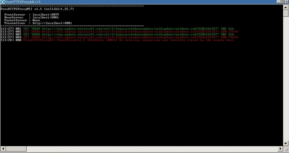

  8. Yes, I realise that now! I misinterpreted what you said in the PS of your post earlier where you said "I disabled the AU Service". The service starts anyway even if set to 'manual' so it might as well be left on 'automatic', as you say.
  9. I've now discovered that if I disable the Automatic Updates service, I get this on every boot in the Event Log. I guess you just can't win! I'll re-enable it again.

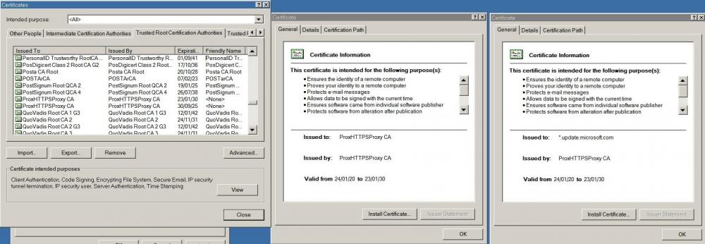

  20. My version of crypt32.dll is 5.131.2600.6459, same as yours, dated 7/10/13.
  21. I did read it, but I didn't try it because I wanted to eliminate the other possibility that we were testing one way or the other first. I will try it now. EDIT: OK I ran wuauclt /resetauthorization /detectnow in a command prompt. Is that all I need to do? Everything else was already as stated.
  22. Sorry to report that about 20 minutes ago, the error message came up again, long after the machine was up and running, with HTTPSProxy active. So, it's nothing to do with the check happening before HTTPSProxy is started. Either the automatic checking system isn't using HTTPSProxy for some reason, or the mechanism is failing due to some other cause. It is strange that checks using the website are fine, and updates are being automatically offered again if they're needed as soon as they're removed, but the routine regular check for updates done by the system is failing. It's not a big issue of course, as there is almost zero chance of an automatic check ever finding anything now, but I'm a bit of a completist, and I'd like to see everything working again!
  23. Thanks all. Just to report no sign of the error message again so far. If it doesn't appear tomorrow or the next day I think we can assume that delaying the automatic update services until after HTTPSProxy is up and running has fixed the issue.
