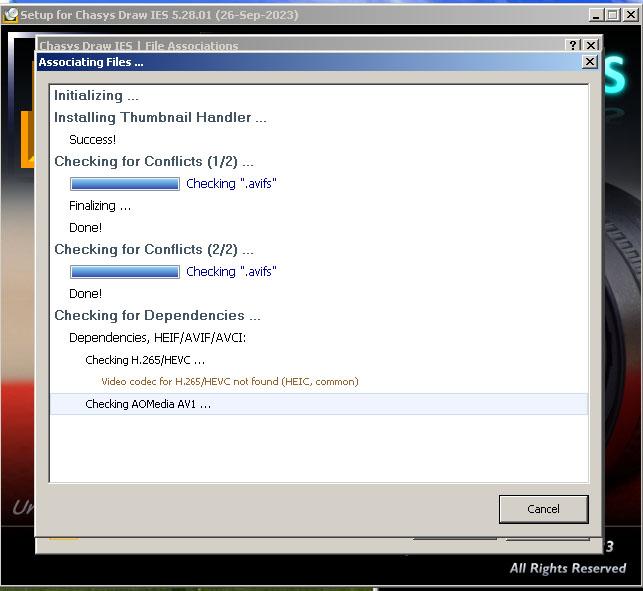

somehow that website x265.com was down and changed weird ? also https://bitbucket.org/multicoreware/x265/ is down here is a working one: https://github.com/videolan/x265 https://www.file-upload.net/download-15418681/x265_3.5.tar.gz.html
