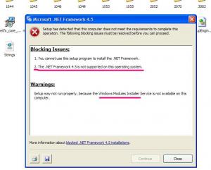

  13. The Windows Module Installer
  14. As you probably know, .NET Framework 4.5 was released as a replacement to .NET Framework 4.0, but with no support for XP. List of changes: http://msdn.microsoft.com/en-us/library/ms171868.aspx System requirements: http://msdn.microsoft.com/en-us/library/8z6watww.aspx Bootstraper and Standalone download link: http://msdn.microsoft.com/en-us/library/5a4x27ek.aspx OR Direct download link for the Standalone installer: http://download.microsoft.com/download/b/a/4/ba4a7e71-2906-4b2d-a0e1-80cf16844f5f/dotnetfx45_full_x86_x64.exe Cheers
