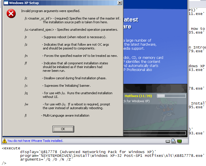

RichTJ99 Posted July 27, 2004 Posted July 27, 2004 Hi,I am getting an error that must be happening during my SVCPack.inf installation. I say must because, the screen (see attached image - not mine) has that same error. When I click OK, the Windows media player screen pops up for a sec (which says to me that whatever was skipped, WMP was close after it. The Image here was borrowed from RuNnaH's posting because it had the same error window (not the other stuff in the background). Here is my SVCPack.inf:[Version] Signature="$Windows NT$"MajorVersion=5MinorVersion=1BuildNumber=2600[SetupData]CatalogSubDir="\i386\Update"[ProductCatalogsToInstall][SetupHotfixesToRun]Q816093.exe /Q:A /R:NQ814995.exe /Q /N /Z /OQ327979.exe /Q /N /Z /OQ327405.exe /Q:A /R:NQ322011.exe /Q /N /Z /OKB870669.exe /Q:A /R:NKB842773.exe /Q /N /Z /OKB841873.exe /Q /N /Z /OKB840374.EXE /Q /N /Z /OKB840315.exe /Q /N /Z /OKB839645.exe /Q /N /Z /OKB839643.EXE /Q /N /Z /OKB837272.exe /Q /N /Z /OKB837001.EXE /Q /N /Z /OKB835732.EXE /Q /N /Z /OKB828741.EXE /Q /N /Z /OKB828035.exe /Q /N /Z /OKB826939.exe /Q /N /Z /OKB825119.exe /Q /N /Z /O KB824141.exe /Q /N /Z /O KB824105.exe /Q /N /Z /O KB823353.exe /Q:A /R:NKB823182.exe /Q /N /Z /OKB822603.exe /Q /N /Z /OKB821253.exe /Q /N /Z /OKB820291.exe /Q /N /Z /OKB819639.exe /Q:A /R:NKB817778.exe /Q /N /Z /OKB810243.exe /Q /N /Z /OWMP9MM2.exeqchain.exeDX9NTopk.exeAny ideas whats wrong?

Aaron Posted July 27, 2004 Author Posted July 27, 2004 RichTJ99 - It mentions on the first page of this thread not to run 817778 in svcpack.inf. Ironically your attachment is called 817778_1.png too
