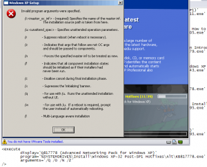

can someone help me with Q817778.exe?
i've tried it with both guirunonce -and- svcpack.inf.
i've tried -q -u -z, i've tried /u /q /z, i've tried /quiet and those switches.
when i do it on my already-installed windows i can get it silent. however, no matter what switches i try, it does the install silently except it pops up with a usage dialog - it's almost like it has a package or command run INSIDE of the package that has the wrong usage inside of it.
anyone have any pointers or anything you can help with possibly?

hi.
you're both wrong.
Q817778 (Switch: Same as "type 1" switches) (23rd July 2003)
Advanced Networking Pack for Windows XP - 1.21 MB
that is the one, and i've tried the suggested "type 1" switches as well.
go ahead, someone try it out on their CD. or someone show me how they launch it and that it doesn't popup ANYTHING. because it pops up a usage error no matter how i do it, as stated above (but it's a usage error AFTER it runs the installation up front... so it's a second embedded setup command it runs or something it seems. and looking at the .infs and such i see no place to modify anything that looks like it will help.)

I've attached an image that shows the error during T-12. It doesn't matter what file name is used, so that confirms what Alanoll already said. Apparently the problem seems to be coming from something that gets executed from inside the hotfix package. Installing it with RunOnceEx causes trouble as well, where QFECheck says that it needs to be reinstalled (which validates after doing a manual install and reboot).
this is exactly the screen that pops up.
no matter where i execute it, no matter what switches.
if anyone has got it to work, please paste your guirunonce line or svcpack line.
nobody has posted yet that it works with proof. just "i've done it in the past" which doesn't help me right now.
which update give the trouble.....? :|
=_=;
KB817778.
