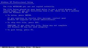

DOS mode setup copy problems:
CLVSXD.ax
QuickTime.qts
QuickTimeEssentials.qtx
QuickTimeInternetExtras.qtx
thanks!
Edited by Kiki Burgh
@Kiki... TAiN mentioned at some point that there could be copy problems related to CLVSXD.ax. I'll have to check that out when I have some time.
The problem with the other three files is a question of running MODIFYPE on them. I'll get on it...

OK. 60703c fixes the "not a valid Windows <whatever> system image" errors... and a few others.
