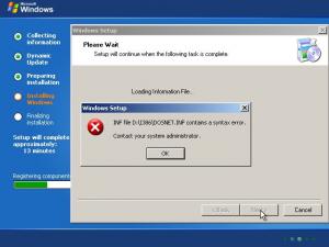

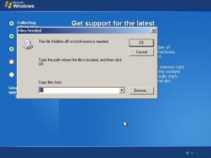

Kiki Burgh Posted July 3, 2006 Posted July 3, 2006 (edited) hi sirs!these are what i have for 60630a ... pls see attachments ...i'm having concerns again about the ff:(1) kbdbhc.dll not being found in the right location (just like before) that i still have to point it to i386(2) RC is not being installed - DOSNET.inf has syntax error as per the pop-up ... & my only option is to cancel ... thus resulting to: "Cannot complete the Windows XP setup wizard"(3) still placing SFCFILES.dl_ in fix results to setup being stuck at T-39 mins ... placing it (SFCFILES.dll) to in APPREPLACEMENT as suggested by Camarade_Tux results to installation ebing stuck at T-9 mins ... incidentally, how do i uncompress SFCFILES.dl_ to become SFCFILES.dll? ... what i did was to just rename the file extension to .dll (4) dos text copy mode has probs w/ the codecs (i'll be posting the same to Tain's thread) though i think i figured a workaround ...i'll post a new msg as apparently my other attachments are not being taken ... thanks!though i noticed there is already a new test rel ... have already downloaded it ...btw, just to share ... i think i didn't get the same issues with 60628 ... Edited July 3, 2006 by Kiki Burgh
Kiki Burgh Posted July 3, 2006 Posted July 3, 2006 Sorry for not getting back sooner on this.I noticed a problem in the DOSNET.INF file you posted, more specifically the reference to WMPreg.inf. Do you know which addon is adding this file? NP TC! i think i prefer not having the shortcuts anymore so my start menu doesn't get that much cluttered ... ... the only prob here is that XPize bootup screen doesn't show anymore when slipstreamed ... as for WMPreg.inf ... if this is re media player ... i could only guess it's the WMP11 (beta) add-on ... but so far it (WMP11) works great for me ...posted new headaches for you TC! ... sorry!
Tomcat76 Posted July 3, 2006 Author Posted July 3, 2006 (edited) The syntax error in DOSNET.INF is in the line referencing WMPreg.inf. Where can I get this WMP11 addon?AC.cab and AC.inf (ZacamAddon_AttributeChanger) are also not properly added into DOSNET.INF. I'll try to find why this is happening. Edited July 3, 2006 by Tomcat76
Kiki Burgh Posted July 3, 2006 Posted July 3, 2006 (edited) thanks for the quick reply ... (just like Germany's bid for WC 2006 )here you go TC: http://www.ryanvm.net/forum/viewtopic.php?t=2319 ... well anyway, it's beta after all as for the other, i'll check Edited July 3, 2006 by Kiki Burgh
Tomcat76 Posted July 3, 2006 Author Posted July 3, 2006 I'm downloading it now, but I don't think it's that. Your new DOSNET.INF and TXTSETUP.SIF do not contain WMPreg.inf.I found the problem. I'll post an updated version soon.

Tomcat76 Posted July 4, 2006 Author Posted July 4, 2006 (edited) (1) kbdbhc.dll not being found in the right location (just like before) that i still have to point it to i386Support for this was dropped a long time ago because it's too difficult to implement. The installation INF for the hotfix that contains this binary needs tons of modifications, not to mention the fact that it's in Unicode (at least the non-English versions are). You can use RVM's Update Pack which includes that hotfix. Edited July 4, 2006 by Tomcat76
Kiki Burgh Posted July 4, 2006 Posted July 4, 2006 (edited) Support for this was dropped a long time ago because it's too difficult to implement. The installation INF for the hotfix that contains this binary needs tons of modifications, not to mention the fact that it's in Unicode (at least the non-English versions are). You can use RVM's Update Pack which includes that hotfix. alright ... didn't know it was dropped ... given that i am not currently using the update pack (as i've learned it quite the hard way --- that i should not include all hotfixes i could get my hands on --- as not all applies to my system ), then i'll just have to remove KB897338 (The new language locales that are included in update 897338 for Windows XP Service Pack 2 and Windows Fundamentals for Legacy PCs) from HF ...The empty SFCFILES.DL_ from FDV just needs to be renamed. It's not a compressed file. as for this ... either it makes my installation lock up at T-39 or T-9 when present --- not that it is a MUST to have but it frustrates me when i couldn't come up with a good build when this file is included either in FIX or HFEXPERT\APPREPLACEMENT dirs ... i have never been successful in any of my attempts --- would there be any workaround for this? i believe it works for the others but why not for me? thanks a lot again! Edited July 4, 2006 by Kiki Burgh
