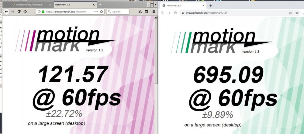

3 hours ago, AstroSkipper said:
hardware acceleration in Mypal 68 and New Moon 28 works great
Edit: My mistake, the "use HW acceleration when available" box wasn't checked. Testing again now.
Another edit: Checking the HW acceleration box makes it slower.
Edited by 66cats
TBH, all this benchmark stuff doesn't help me at all. :no: I play a certain YouTube video on the browsers and know immediately whether hardware acceleration is being used or not. The problem with Thorium, however, is that part of the hardware acceleration (GPU rasterisation) is not running properly on my hardware. Your benchmark images don't help me at all. And comparing different browsers with each other makes no sense either. You have probably not configured Mypal 68 correctly via about:config. Switching on hardware acceleration in the options page of Mypal 68 is not enough, at least in my installation.
