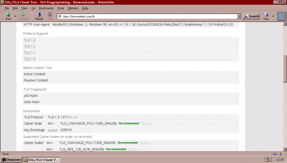

seven4ever Posted June 2 Share Posted June 2 On 6/1/2024 at 8:31 AM, seven4ever said: Wow thanks, I use still Retrozilla ! Yes Tls 1.3 was missing. Tested on Win 95, works! Update works too for Netscape 9 on Nt4 2 Link to comment Share on other sites More sharing options...
