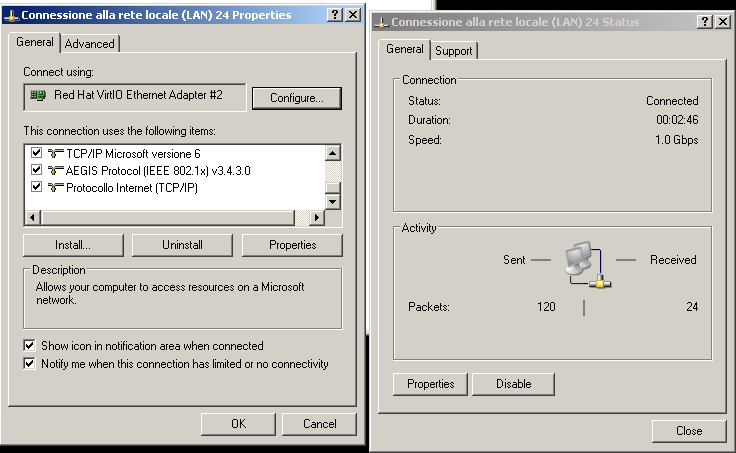

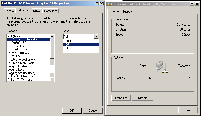

FranceBB Posted September 30, 2023 Posted September 30, 2023 Hi there everyone, I'm using virtio-win-0.1.229 on Virtualbox 7.0.97 with Windows XP x86. Once the driver is installed, it can be set in several different modes, namely 10 Mbit/s, 100 Mbit/s, 1000 Mbit/s 10000 Mbit/s. By default in Windows XP it's set to 1000 Mbit/s, so 1 Gbit/s. As soon as I change it to 10 Gbit/s, however, I get a bluescreen. I tried to ask on GitHub about this and I also asked the virtio guys whether they were gonna release any updates for XP and they clearly said "no" and that XP is out of support. -.- So the questions I'm asking is: Do you guys actually use virtio on XP in a VM? Which performances do you get? Given that virtio is open source, has anyone actually ported a modern version of the ethernet driver (NetKVM) to XP? (and if so, why wasn't it committed via a pull request?). A side note: I'm using the PAE 128GB RAM patch, so I really hope it's not the one causing those bluescreens... A few more info about the current issue I'm facing and my testing platform: Software environment - Host Operating system: Fedora 38 - Host Architecture: x64 - Host kernel version: 6.2.12 - Host Hypervisor and version: Virtualbox 7.0.97 r156983 - Guest Operating system: Windows XP Professional (with Microsoft Updates 'till July 2019) - Guest Architecture: x86 - Guest libvirt version: virtio-win-0.1.229 Hardware environment - CPU: i7 6700HQ 4c/8th 2.60GHz - RAM: 64GB DDR4 (2x32) - GPU: NVIDIA GTX 950M 4GB GDDR5 - SSD: Samsung EVO 1TB Sata III (OS) - SSD: Samsung QVO 1TB Sata III (Data) - SSD: Intel 660p NVME 1TB (Virtual Machines) Description of the problem I noticed that, when switching to virtio, the default reported connection speed reported was 1 Gbit/s despite the fact that the virtual adapter should support 10 Gbit/s. I went in the settings and changed the reported speed from 1 Gbit/s to 10 Gbit/s (it's possible to do it from the registry as well, eventually), however it bluescreened. Steps to reproduce 1. Choose virt-io in Virtualbox as network adapter 2. Boot Windows XP Pro x86 3. Install the virt-io Windows drivers from the latest ISO (virtio-win-0.1.229.iso) 4. Reboot 5. Go to the correctly recognized virt-io network adapter and change the configuration from 1 Gbit/s to 10 Gbit/s 6. Confirm, apply, ok, close all the windows and wait for the bluescreen Pictures showing the issue:

Dixel Posted September 30, 2023 Posted September 30, 2023 12 hours ago, FranceBB said: 6. Confirm, apply, ok, close all the windows and wait for the bluescreen Pictures showing the issue: Reading Italian is not one of my strongest abilities, but I'm pretty sure by "disco" they didn't mean the music style. Memoria or disco wording means they suspect your HDD or RAM be at fault, which could also point to the PAE patch. PAE patch doesn't get friendly with Nvidia drivers, the combination of PAE+Nvidia drivers don't go well with network drivers. 3
