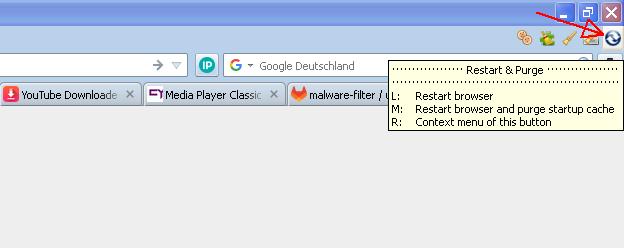

AstroSkipper Posted October 5, 2024 Author Posted October 5, 2024 (edited) On 2/10/2024 at 7:29 PM, AstroSkipper said: Restart & Purge - A custom button for restarting the browser and, if necessary, purging the startup cache, created by AstroSkipper As I have already reported in @roytam1's browser thread, I have been investigating the restart behaviour of New Moon 28 and Serpent 52 (and also Mypal 68, but this is off-topic here) for some time with a focus on the startup cache. Unfortunately, I have not been able to find much useful information or documentation on this topic on the internet. Even my request in @roytam1's browser thread also went unanswered (addendum: in the meanwhile, @VistaLover has replied here. Thanks again for that! ). It seems that detailed information or knowledge about the startup cache and how the browser restart affects this cache is practically non-existent. The startup cache seems to be a replacement for the former Fastload. It resides in the profile directory to store continuous chunks of data in it. In my New Moon 28 installation, without using the custom folder chrome for scripts and CSS stylesheets, only one file resides there with the name startupCache.4.little. As both, the folder and file name, contain the string startupcache, one can conclude that data is stored inside this file to accelerate the startup of the browser. Which data exactly I really don't know. I didn't find any meaningful documentation. I noticed that very often or in most cases the startup cache was cleared or reorganised automatically without any additional commands when restarting the browser. Sometimes, however, it remained unchanged after a restart. At least, I could find the code responsible for purging the startup cache. Anyway! One thing is clear. If the data in the startup cache is corrupted, then starting problems can occur which only can be solved by deleting its content. This can be done, for example, manually or by the commandline option -purgecaches. But there is no button or item to start this purge of the startup cache in a convenient way from within the UXP browsers. That's why I created a custom button for this purpose in JavaScript (rather a variant of JavaSript), the programming language used for creating new custom buttons by the extension Custom Buttons. I branded this custom button Restart & Purge. It performes a normal restart when left-clicked and additionally purges the startup cache when middle-clicked. After creation I have tested this custom button over a longer period of time, and it works for me as it should. Here is a small screenshot of my custom button Restart & Purge and its tooltip taken from New Moon 28: As the code of Restart & Purge has to be initialised, you won't find it in the tab "Code" but in the tab "Initialization code" of this custom button. Here is a screenshot of its code: The former download links unfortunately contained an XML backup file of the Restart & Purge custom button which either couldn't be installed without additional editing or some characters were not transferred correctly. The problem has to do with the conversion of custom buttons into XML format, where the tool I had used did not work correctly. This time I therefore provide a custom button link for direct install (when the extension Custom Buttons is already installed, of course ). Copy the quoted link below and open it in a new browser tab: I can't insert the code of the link in this post! The MSFN forum editor is totally broken and hasn't been working properly for months especially when it comes to inserting of links. This has already reported multiple times! Well done, who is responsible for it! Due to the shortcomings of the MSFN forum editor, I uploaded the custom button link of Restart & Purge as an HTML file. Here is the download link: https://www.mediafire.com/file/nrqim7ek9s6gp07/CB_button_Restart_%26_Purge.html/file Simply open this HTML file in a browser tab and click the embedded custom button link for Restart & Purge! For the installation of this button, the extension Custom Buttons is required which you can get from this post: https://msfn.org/board/topic/183923-extensions-and-custom-buttons-for-uxp-browsers-corrections-modifications-adjustments-and-special-recommendations/?do=findComment&comment=1226328 And since the legacy Custom Buttons extension runs in the UXP browsers, my custom button Restart & Purge can be used in New Moon 28, Serpent 52, Pale Moon and some other browsers. Greetings, AstroSkipper I have updated the code of my custom button Restart & Purge to let it run the fully native restart code inside the UXP browsers to avoid any abnormalities. Restart & Purge v2.0 will be released soon after some additional tests. In any case, it should work then with New Moon 28, Serpent, Firefox 52esr and even the non-UXP browser Mypal 68. And most probably also with Pale Moon and Basilisk (the call up of the native restart code should be the same as in the other browsers) which I can't test, though. Cheers, AstroSkipper Edited October 5, 2024 by AstroSkipper Update of content 2
