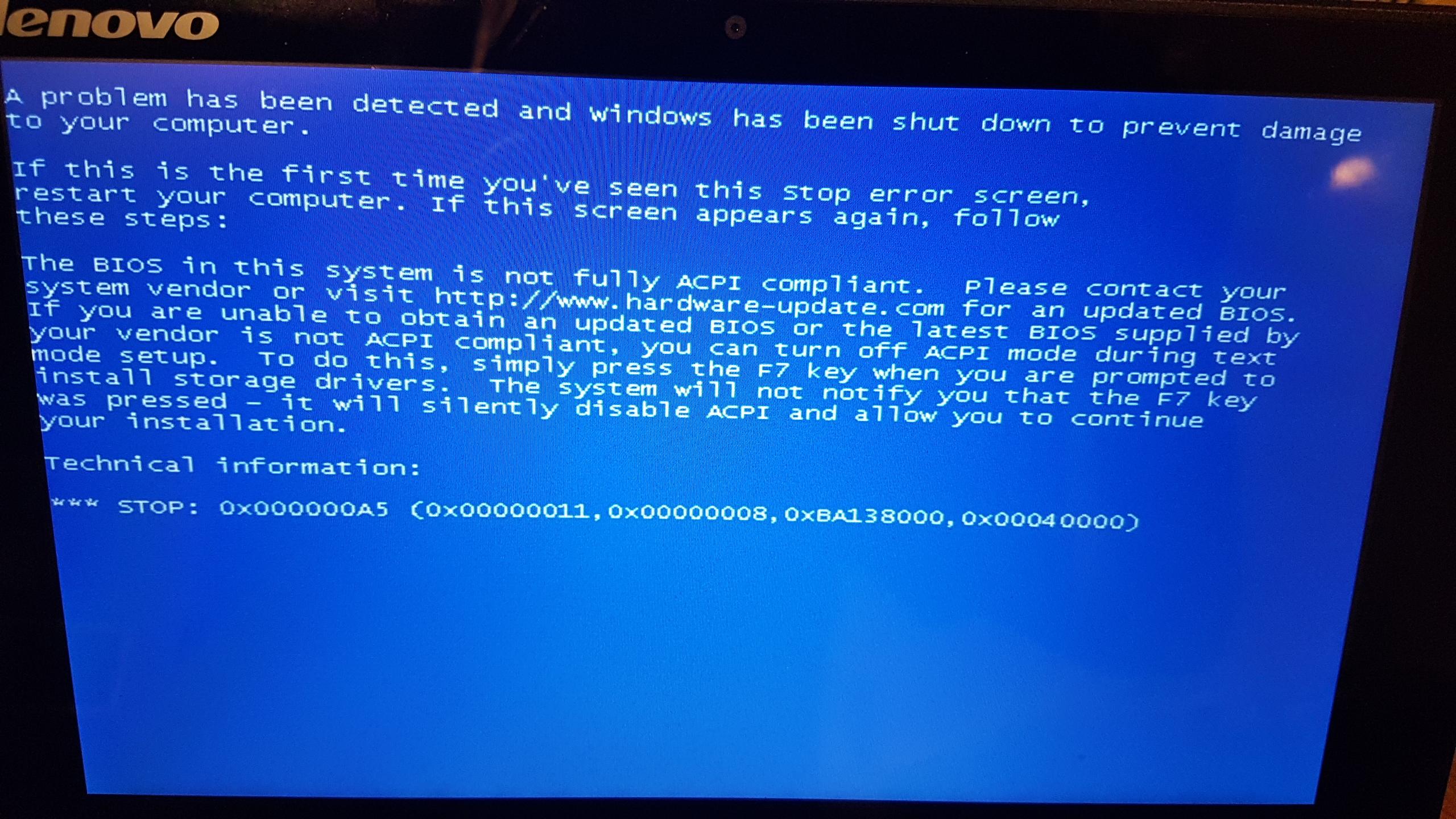

39 minutes ago, daniel_k said:
@Dave-H
Sent you a PM with acpi compiled with the latest patch for your Flex 10 laptop, thanks to @Mov AX, 0xDEAD
OK, I tried that file, and got the same BSOD.
I then checked in Windows 10, and found that the setup hadn't actually copied the new file to system32\drivers, it was still the original.
I manually copied it, and the BSOD went away, temporarily!
The setup continued, but on the next reboot the BSOD came back again, exactly the same.
I then used the 'Last Configuration That Worked' option and it then rebooted successfully and carried on!
The system does not restart, it freezes permanently on the 'Windows is shutting down' screen, and I have to do it manually.
On the next reboot, the BSOD came back again, and I had to use 'Last Configuration That Worked' again.
Setup then continued again and this time it carried on until the very last stage, when instead of loading the desktop, it just permanently froze.
On reboot it loaded up OK.
When installing devices, it said that hal.dll was being replaced with an older version and asking if I wanted to do it, and I said no.
On the next boot I got a message that hal.dll is missing or corrupt, and I now can't boot at all!
Should I try to restore it using Windows 10?
Presumably @George King's ISO which I'm installing from, would be OK.
:dubbio:
I seem to remember the business with different HAL versions is quite confusing, at least to me, as different files change their name and become hal.dll depending on what HAL you're using. I just want to get it to boot again without having to do the whole install again!
It seemed logical to me not to replace a newer file with an older one, but in this case it was obviously the wrong thing to do!
Posted (edited)
@Dave-H
I use an own harddisk for XP in the Flex10. This harddisk before I write with Winhex 00 everywhere and prepare it with RMPrebUSB
with MBR, ntldr, NTFS and force use of LBA.
Then I install XP SP3 from scratch with the new acpi.sys V5 integrated.
All works at once and very fast install.
The only things that still not work on the Flex 10 under XP SP3 is the 3D graphik, because no driver for it.
And also reboot still does not work (I never see this on any other compi), only shutdown works
Dietmar
PS: I use the Storahci driver from Kai Schtrom.
Edited by Dietmar
Posted (edited)
:dubbio:
Place it to standard $OEM$ location and reinstall :) When ACPI found in this location it's overwriten on possible places and repacked to SP3.cab too.
Edited by George King
That's exactly what I did with the new acpi.sys, but the setup didn't appear to use it.
I have had this happen before, and sometimes the files get used and sometimes they don't, and if you remember sometimes they vanish from the folder as if they've been moved instead of copied, but it seems to be very inconsistent.
:dubbio:
