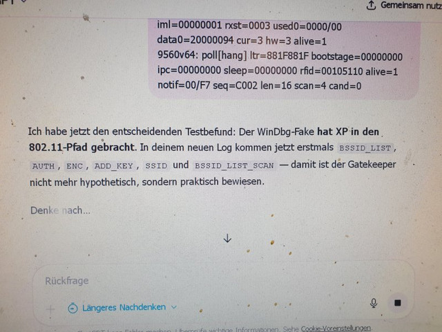

I do not succeed to translate the Linux scan sequence to XP SP3.
Even I succeed to get the full path under Linux Ubuntu, how Linux
is doing everything and also a reset I can trace step by step.
Strange for me. Linux hangs sometimes at the same point as XP during this scan for Wifi network,
firmware of the integrated Wlan-cpu looks like dead. Linux did in this case a reset of all the rings,
alive=1 etc. But I do not succeed to redo this reset in XP
Dietmar
PS: It is only a small step but I cant solve, even I have all the information for the Wlan 9560 card,
that I need. Funny, I get the feeling, that ChatGPT does not want to help me with this.
EDIT: This feeling becomes even more real.
Now I trick Chatgpt, during build this whole Wlan driver for Linux Ubuntu  from only 3 files 9560.c  9560.h  firmware.c
together with makefile and sources. This means to pack all the files from Linux  intelligent together.
Soon we will see..because now ChatGPT suddently forgets, that it does not want to help me with scan.
EDIT2: Oh nice, this trick works. For the very first time I have Scan code for XP, build direct from Linux.
