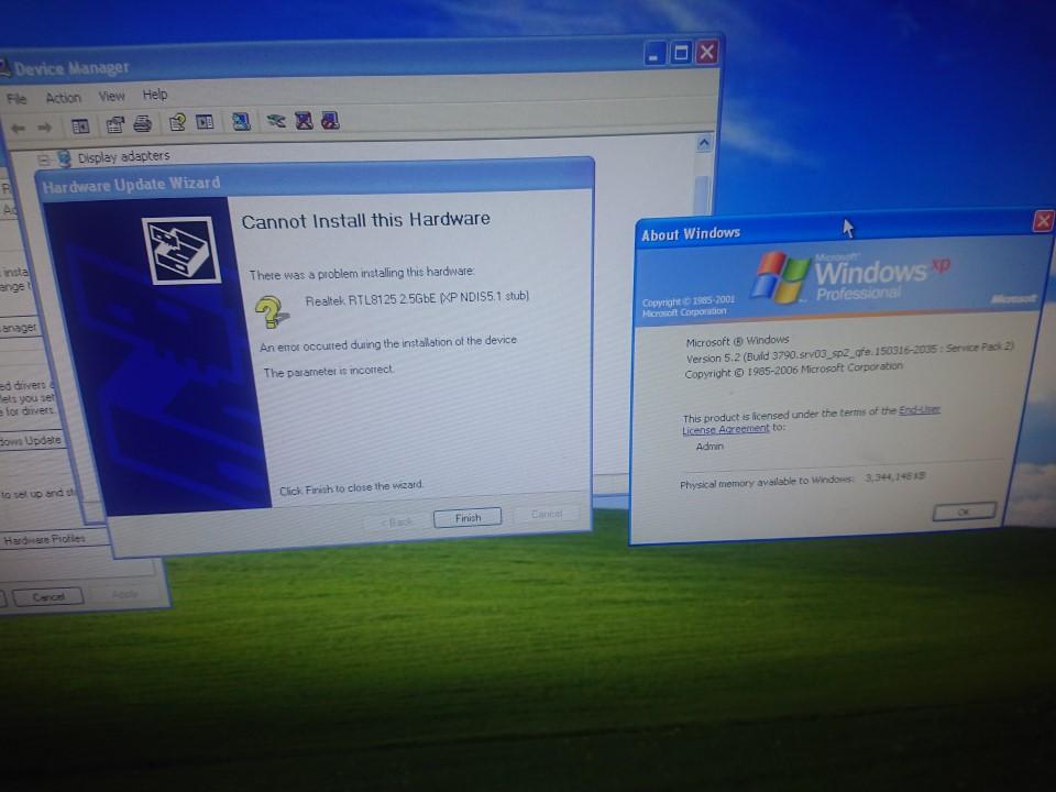

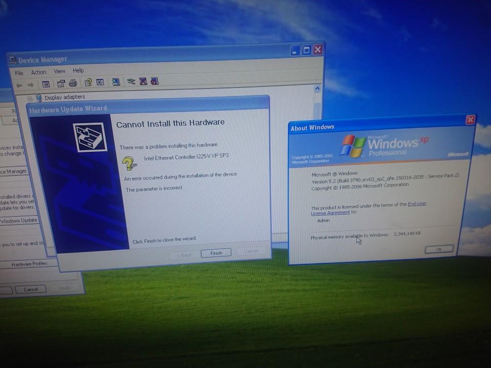

I finally got around to testing the drivers on my B550 Tomahawk, I wanted to test RTL8125 drivers on the well RTL8125, and the I225 drivers on my I226-V, and I figure I'd test both in the same system to make it easier. I have no custom install disk of XP x86 that will just work on Ryzen with ACPI patch and USB and such, and I do not feel like fussing with trying to make my own, so I just used the patched version of NT 5.1 XP from the Universal NT Installer project. Installed to a FAT32 partition and just used default settings and boot options. I installed some other drivers before I made the vids, but I also tested with a fresh install with no other drivers and saw the same behavior.
With the RTL8125, I initially get no connectivity for like 10 seconds or so, until I get a DRIVER_IRQL_NOT_LESS_OR_EQUAL BSOD, 0x000000D1 from NDIS.sys. After reboot the device doesn't start with a code 39.

With the I226-V, I have to manually install the driver, but it works. In this video, I install all three, however it detects a 2.5 Gbps link when it's only a gigabit link. Speeds also leave a lot to be desired, I know fast.com is not scientific, but I don't have a 2.5G link to test where this PC is and it still gives a good ballpark speed. Also installing i225IRQlaaastfree at the end results in a 0x40000080 BSOD.

One more thing, I noticed there also was a NT 5.2 x86 (Server 2003 x86) in the Universal NT Installer but themed to be like XP. So I tried that too, however both drivers refuse to install on it and idk why. Only "The parameter is incorrect." with nothing else to go off of.
comp1.jpg.095518106cea7d52ac5d85582060f7c2.jpg comp2.jpg.8372d71a2f9a39041bcd124d25875f68.jpg
