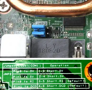

reboot12 Posted March 14 Posted March 14 (edited) 2 hours ago, Dietmar said: Do you can see now CSM or with other name in Bios But I didn't modify the bios. Normally you can only make a backup and flash of the 14.9 MB BIOS region: fpt -bios -d BIOS_region.bin Thanks to the Service Mode jumper, you can make a backup and flash of the full 16 MB BIOS (the entire SPI chip): fpt -d full_SPI.bin I wrote earlier that changing hidden BIOS options does not help and CSM does not work. P.S. I still need to test different settings of the JMP2 jumper of the COM1 port - because now WinDbg does not work with the default setting: WinDbg require null-modem cable with bridge pin 1-6: https://learn.microsoft.com/en-us/windows-hardware/drivers/debugger/setting-up-a-null-modem-cable-connection#null-modem-cable-wiring Maybe this jumper block working WinDbg - I need test it. EDITED ===== I test all jumper combinations but not help. WinDbg not work because OS debug mode not boot and only black screen. This COM1 port is not useable to debug Edited March 14 by reboot12
