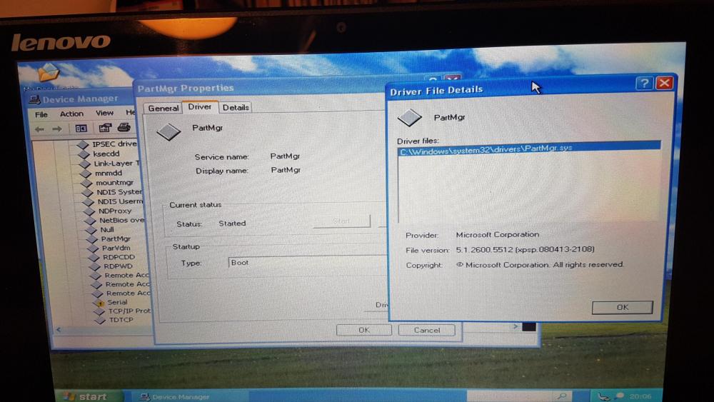

Dietmar Posted May 11, 2022 Posted May 11, 2022 @Dave-H Now your Flex 10 behaves exact as mine. When I show in Device Manager all hidden devices, I see a yellow question mark at partmgr. This device you need, in other case you get Bsod 0x7B. I think, there is a conflict between something, but the behavior, that you describe, happens the same in Safe Mode via F8 or with emergency start with nearly no drivers. Is there a Log file at boot time from XP, that can tell more? May be, that there is also a possibility to use Windbg for to check this, but I dont know how Dietmar PS: Today in the afternoon I make an install from original XP SP3 CD in IDE mode, just naked, only with new acpi.sys V5 and look, if then the install logs tell something more.
Dave-H Posted May 11, 2022 Posted May 11, 2022 @Dietmar No apparent problem with partmgr here. 'Serial' is the only hidden device showing an issue, and that can't be started apparently because there are no devices associated with it (perhaps it's for a serial port?) I am very puzzled why the audio driver does not stay loaded over a reboot. I would have thought that once all the necessary registry entries were there for it, it would load OK every time. Here's the bootlog. ntbtlog.txt
