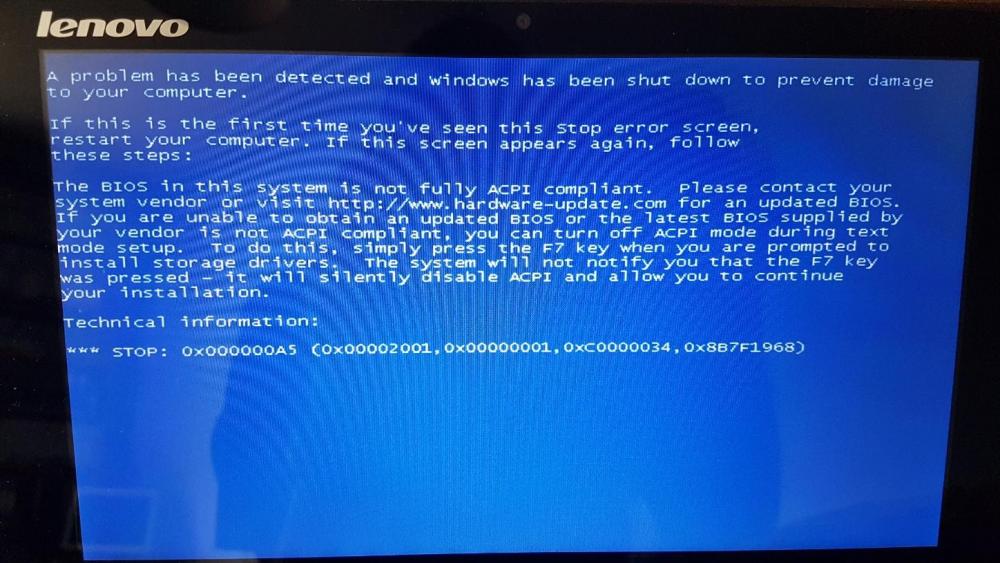

Dave-H Posted May 5, 2022 Posted May 5, 2022 No joy I'm afraid, instant A5 BSOD on the reboot with all three versions.
Damnation Posted May 5, 2022 Posted May 5, 2022 @Dave-H post a screenshot of the BSOD, maybe some of the parameters about the error have changed?
Dave-H Posted May 5, 2022 Posted May 5, 2022 OK, here it is! The numbers are indeed different, but I have no idea whether that's significant or not.
Damnation Posted May 5, 2022 Posted May 5, 2022 @Dave-H BSOD A5 0x2001 - ACPI tried to evaluate the PIC control method but failed. This would explain why you're running out of hardware resources too, Programmable Interrupt Controller isn't working properly so you're running out of Interrupts. This is one of the unresolved BSODs mentioned on page 1 of this thread, so setting up windbg is a must to solve this. Sorry this is turning out to be so complicated for you @Dave-H
