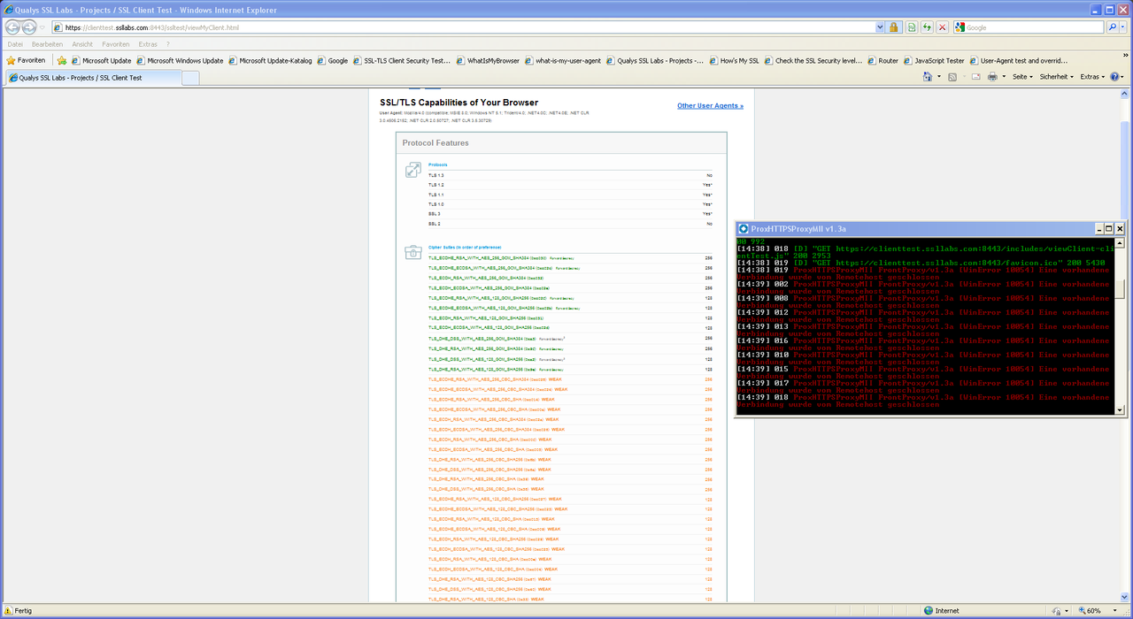

AstroSkipper Posted November 15, 2023 Author Posted November 15, 2023 (edited) 10 hours ago, WSC4 said: I am now reading articles that beginning December 1, 2022, Microsoft will begin turning off the Transport Layer Security (TLS) 1.0 and 1.1 protocols for POP3 and IMAP4 and enforce the use of TLS 1.2. Check on the website https://browserleaks.com/ssl which TLS protocols and ciphers are supported by ProxHTTPSProxyMII 1.3a! I personally never used it. Therefore, I don't know which TLS protocols and ciphersuites are offered by this old version. Edited November 15, 2023 by AstroSkipper 2

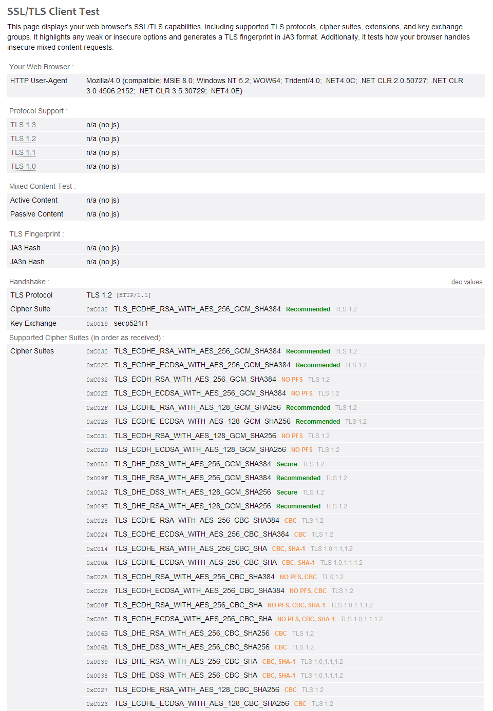

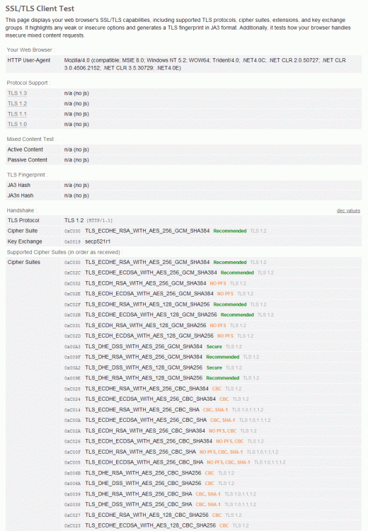

WSC4 Posted November 16, 2023 Posted November 16, 2023 OK. I put in browserleaks.com in config.ini just under [SSL No-Verify]. I also put it into IE trusted sites. Was that the correct thing to do? IE 8 displays this:
AstroSkipper Posted November 16, 2023 Author Posted November 16, 2023 (edited) 2 hours ago, WSC4 said: OK. I put in browserleaks.com in config.ini just under [SSL No-Verify]. I also put it into IE trusted sites. Was that the correct thing to do? IE 8 displays this: Not really. Actually, you do not need to add browserleaks.com anywhere. So, why did you do that? Anyway! Please, remove these entries! If ProxHTTPSProxyMII 1.3a has been configured correctly, entered as a proxy in IE and started, it should work immediately when calling up browserleaks.com in IE. In any case, the website must not show n/a (no js). Your current settings block JavaScript on this website. No good. All SSL connections should be processed by ProxHTTPSProxyMII. You should only modify the config.ini file if you really know what you are doing and for what reason. Otherwise, the proxy won't work as expected due to misconfigurations. Edited November 16, 2023 by AstroSkipper Update of content 3
AstroSkipper Posted November 16, 2023 Author Posted November 16, 2023 (edited) 4 hours ago, AstroSkipper said: Not really. Actually, you do not need to add browserleaks.com anywhere. So, why did you do that? Anyway! Please, remove these entries! If ProxHTTPSProxyMII 1.3a has been configured correctly, entered as a proxy in IE and started, it should work immediately when calling up browserleaks.com in IE. In any case, the website must not show n/a (no js). Your current settings block JavaScript on this website. No good. All SSL connections should be processed by ProxHTTPSProxyMII. You should only modify the config.ini file if you really know what you are doing and for what reason. Otherwise, the proxy won't work as expected due to misconfigurations. Generally, everything I said in my last post applies. But unfortunately not for https://browserleaks.com/tls which does not work properly with ProxHTTPSProxyMII 1.3a due to certificate problems. I have just tested it. As we already know, this old proxy supports only SHA1 for signing certificates but not SHA256. For browserleaks.com, you need a more recent version of ProxHTTPSProxy and a more recent browser. No full functionality in IE8 anymore. Therefore, forget about https://browserleaks.com/tls and try https://www.ssllabs.com/ssltest/viewMyClient.html! Here is a screenshot accessing https://www.ssllabs.com/ssltest/viewMyClient.html with ProxHTTPSProxyMII 1.3a and IE8: This service works with the old ProxHTTPSProxyMII 1.3a. As you can see, the old proxy already supports the TLS 1.2 protocol. Therefore, it should work with MU/WU. But one thing is clear: ProxHTTPSProxyMII 1.3a is obsolete and won't work properly with many sites in these days. Cheers, AstroSkipper Edited November 16, 2023 by AstroSkipper Update of content 3
