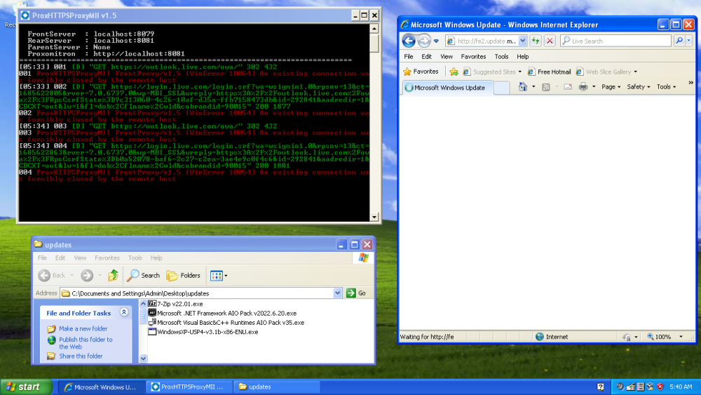

Result; PopMenu and Min2Tray started fine, but Microsoft Update page is reloading none stop in Internet Explorer 8..
Everything was tested on a fresh installed Windows XP in VirtualBox. Not sure what I do wrong here, but it's like an abstract labyrinth to get this to work. :blink:

32 minutes ago, Outbreaker said:
Okay i give it another go here is what i did.
1. Installed Microsoft Visual C++ 2015-2019 Redistributable v14.28.29213.0. (DONE)
2. Installed lasted Microsoft .NET Framework 4.0 with Updates. (DONE)
3. Extracted Zip-Archive file "ProxHTTPSProxy_TLS_1_3_1_5_220717_PopMenu_3V3" to "C:\". (DONE)
4. Turn Off Windows XP Firewall.  (DONE)
5. Executed the file ".\ProxHTTPSProxyMII_CertIns_Windows\ProxHTTPSProxy Cert Install.exe" from the extracted Zip-Archive file. (DONE)
6. Executed the file ".\PopMenu\Configure PopMenu.exe" from the extracted Zip-Archive file. (DONE)
Ok! That looks much better. Now, you have a problem with accessing the Microsoft Windows Update page. As I already wrote, you should follow my guide Complete guide for restoring IE's access to WU/MU website using ProxHTTPSProxy or HTTPSProxy in Windows XP. This guide is well-tested, too, and after doing all steps, MU should actually work. The problem with the loops is probably caused by a misconfiguration of the Internet Explorer. Please read especially step 4 of my guide (but all other steps are also important, of course)! starescreen.gif
Edited by AstroSkipper

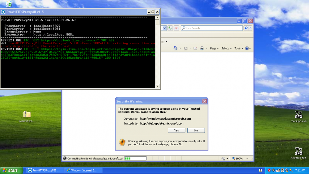

I tried again, but it refuses to work on my side.
Not sure if i should get this popup message below or not.
Edited by Outbreaker
  • Author
No, you actually shouldn't get this popup message. Did you configure IE exactly as I wrote in my guide?
Quote
4. Configure Internet Explorer. Internet Zone to standard, Trusted Zone to high with only these three URLs associated with MU: http://www.update.microsoft.com/https://www.update.microsoft.com/ and  http://update.microsoft.com/. Credits to @maile3241 and @AstroSkipper. Go to Internet Explorer Options, Advanced. Check if TLS 1.2 is enabled. Uncheck entry "Check for server certificate revocation".
Please provide screenshots of your IE settings! Do not add http://fe2.update.microsoft.com/ to the Trusted Zone of IE!
