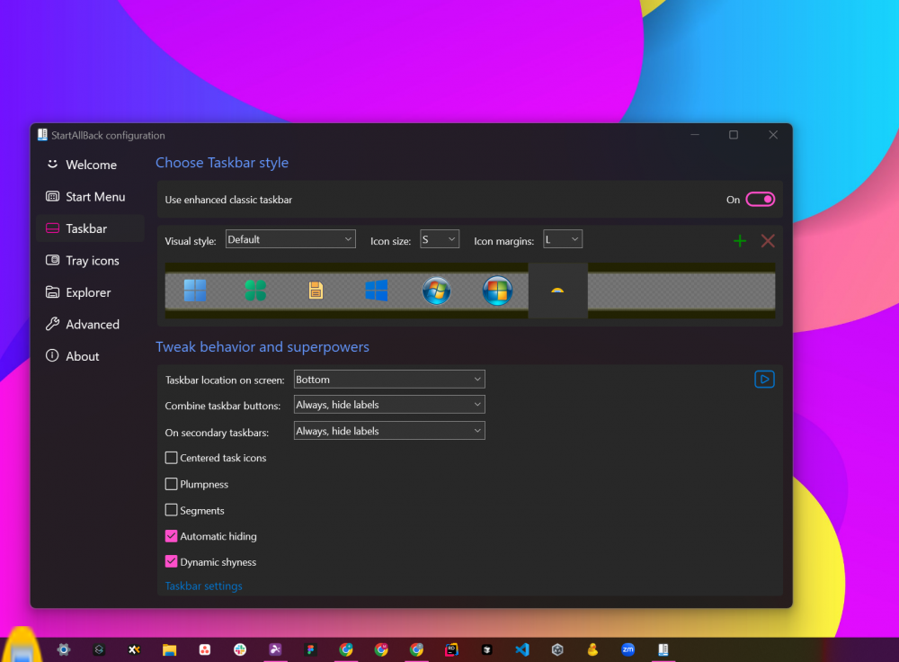

znerolnoht Posted July 26 Posted July 26 I'm trying to make a new taskbar icon for the start menu. I can see where to add one but trying different file sizes and types (pngs, svgs) results in an error or the icon is incorrectly displayed. Can you help with the requirements/formatting for a PNG or SVG?

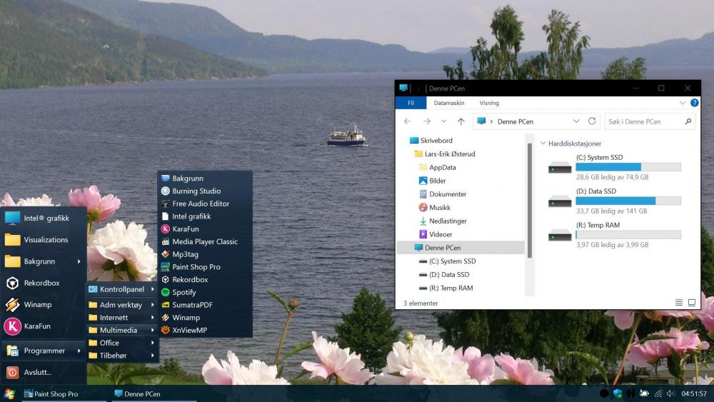

Lars-Erik Posted July 28 Posted July 28 2 hours ago, Uiti P. Uszer said: Feature Request: Could you please add a Classic (Win 2K, 9x style) Start Menu theme, like Open Shell has. Or can anyone link to a 3rd party Classic Start Menu theme for SAB? I second this. I use Open Shell to get to old style meny (see screenshot from Windows 10) and on Windows 11 I now have to use both StartAllBack and OpenShell.
