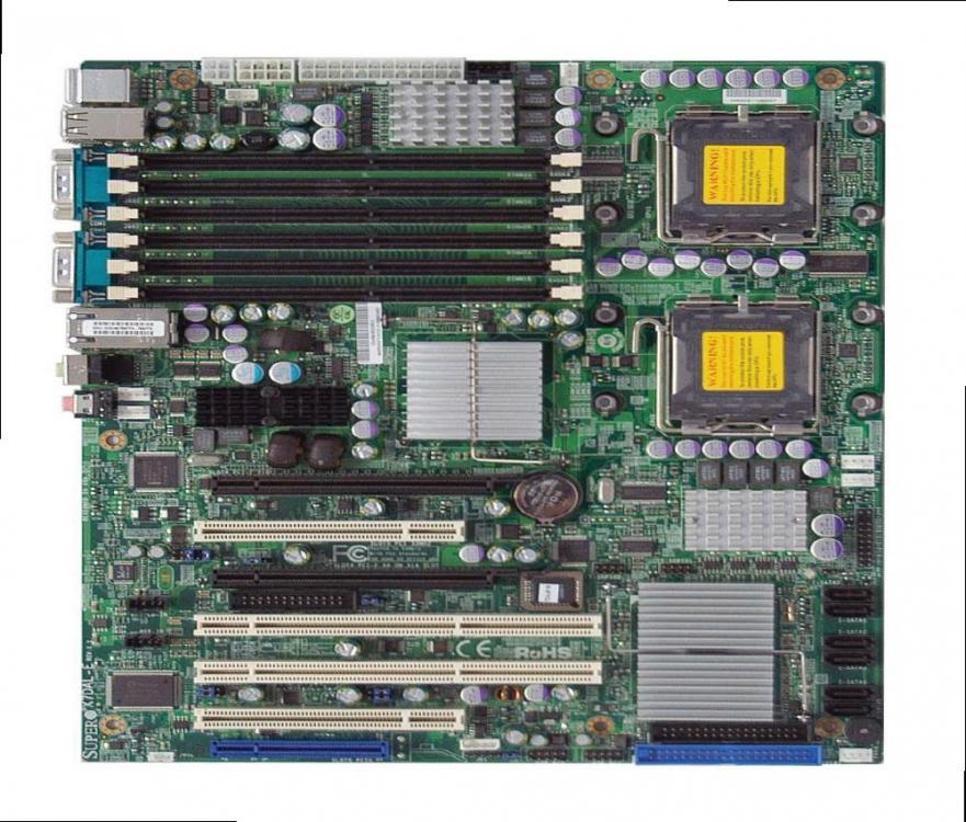

One of those extenders could potentially solve my problem, as I could then fit an ASMedia card using it, as long as the 'plug' end will go into the PCI-U socket, which it looks as if it will.
You can see the PCI-U socket, the short blue one, at the bottom left of the board in the picture.
I have a small card plugged in there at the moment which feeds my DVD drive, but that's using the SATA socket on the card top edge, the eSATA socket on the card side edge is inaccessible as that socket has no removable plate beside it like the other six slots above it as it's (I think) designed for an internal expansion card of some sort.
Obviously, I wouldn't want the card flying around loose in the case, but I'm sure that can be sorted out!
