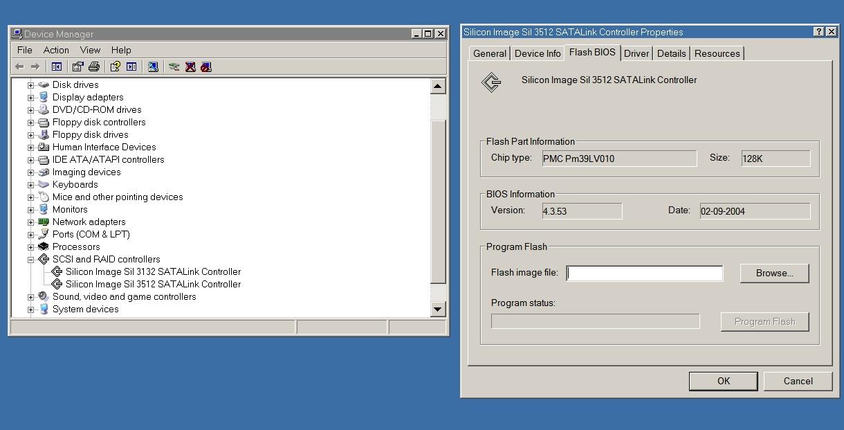

Dixel Posted January 22, 2024 Posted January 22, 2024 This board has a firmware update available. Could the issue be the reason for such an update? Silicon Image SiI3512 BIOS v.3.06 https://driverscollection.com/?file_cid=42198874113f2f2009758fd609b 3
Dave-H Posted January 22, 2024 Posted January 22, 2024 Thanks @Dixel but it looks as if the BIOS on my card is already a later version than that, 4.3.53.
Dixel Posted January 22, 2024 Posted January 22, 2024 3 hours ago, Dave-H said: Thanks @Dixel but it looks as if the BIOS on my card is already a later version than that, 4.3.53. You're welcome Dave! Despite what the version number says, the BIOS files inside are newer, they are dated as of late 2010. It's some sort of a BIOS update with the same chip, but manufactured by Acer. I extracted the update, it's much newer than yours from 2004. 3
