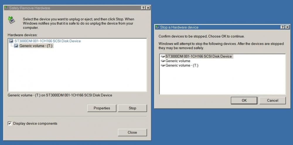

Something else I noticed and forgot to mention, in case it's relevant.
When I look at the 'safely remove hardware' window in XP with the 3TB disk mounted, I see this.
Why are there two 'generic volumes' listed?
With the other disks I tested, there was only one.
:dubbio:
