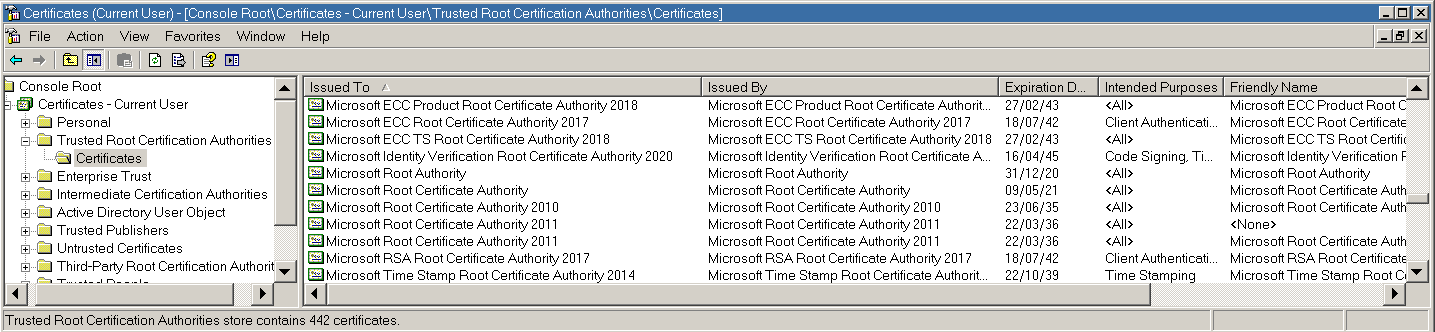

Well here's my equivalent.
I assume we're looking at the Current User certificates, not the Local Machine certificates, sorry I don't know any German.
Does anything look wrong there?
:dubbio:

Posted (edited)
You're absolutely right. My screenshot belongs to current user. When you compare yours to mine there is one thing strange and this is your Microsoft Root Cerificate Authority 2011. You have twice and I don't know why.
If it were my system I would delete the one with "Friendly Name" <none>.
Edited by AstroSkipper
addition
I tried flushing the DNS cache but no difference I'm afraid.
:no:
The Microsoft Root Certificate Authority 2011 entry that I have and you don't is the one with <None> as its friendly name.
I wonder if I should just delete it?
:dubbio:
@Dave-H You was too quick in replying! :yes: But I agree. Delete it!
Posted (edited)
11 hours ago, Dave-H said:
Anyway, I have deleted it, but still no effect I'm afraid.
Sometimes a reboot is necessary especially after changing system settings and configurations. And delete the Internet Explorer cache. By the way have you ever tried reregistering following components in the command prompt? Here if not:

ProxHTTPSProxy appears to be working fine on other sites, but shows no output now on Microsoft Update.
:dubbio:
1 minute ago, Dave-H said:
I did re-register those files some time ago, but it didn't change anything.
Initpki.dll took a long time before it reported that it was registered, the other three were pretty instant.
Anyway, I've given all that a try, and the only thing which didn't seem to work in the cmd file was replacing wuaueng.dll.
After rebooting I found there was no wuaueng.dll in the DLLCache folder, and the one in System32 was version 5.4.3790.5512, the one from SP3.
Anyway, I corrected that manually, and the version now in System32 and the DLLCache is 7.6.7600.256.
I'm now getting this -
There are a number of sites now listed in the Trusted Sites list, more than before, and more than the message says.
They are -
*.microsoft.com
*update.microsoft.com
*windowsupdate.com
*windowsupdate.microsoft.com
http://update.microsoft.com
http://www.update.microsoft.com
https://www.update.microsoft.com
:dubbio:
