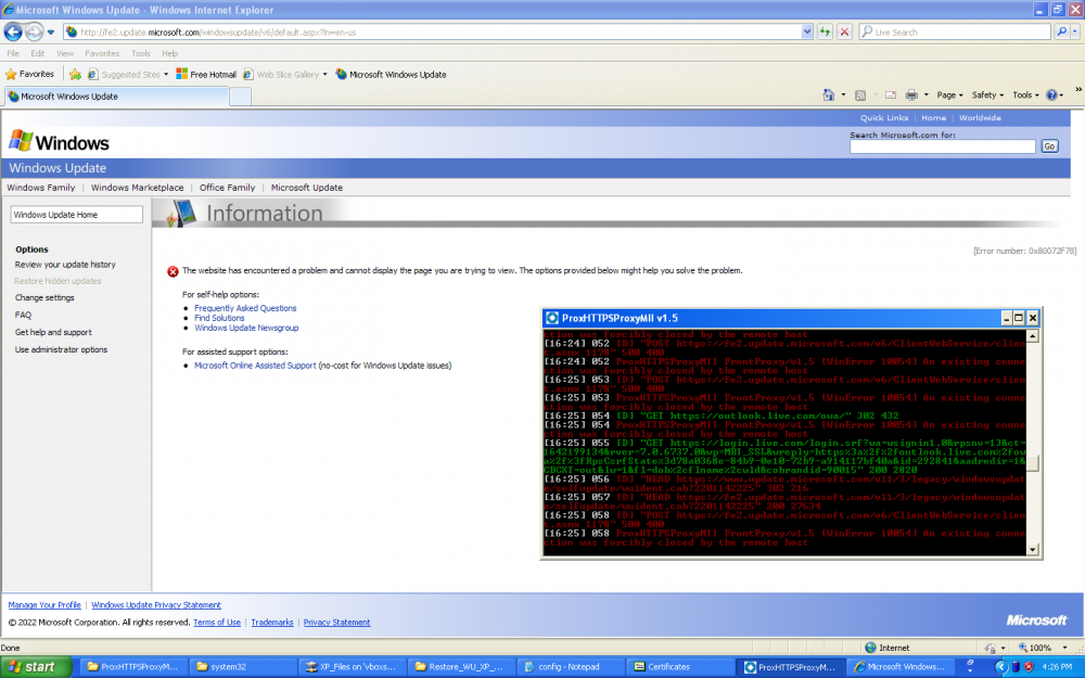

Installed the new ProxHTTPSProxy certificate and so close now, but not yet. It tries to connect now to https://fe2.update.microsoft.com/v6/ClientWebService/client.asmx But I still get a 500 error response, I am sure this can be fixed, maybe we need more root certificates or ProxHTTPSProxy is sending faulty data.
Edited by xpandvistafan

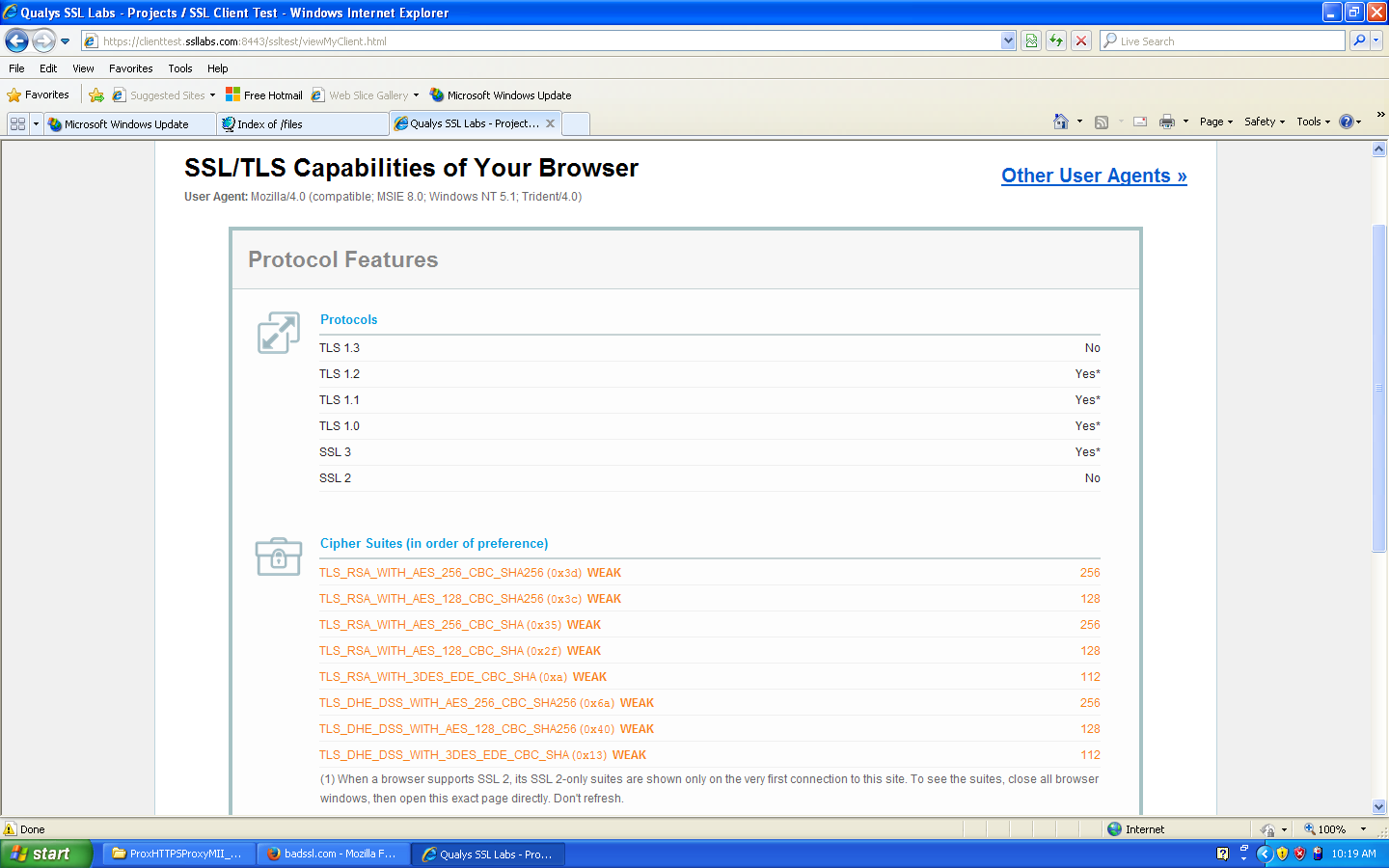

Have you found the update that is missing? This is my ssltest results for IE 8 with TLS 1.2 support.

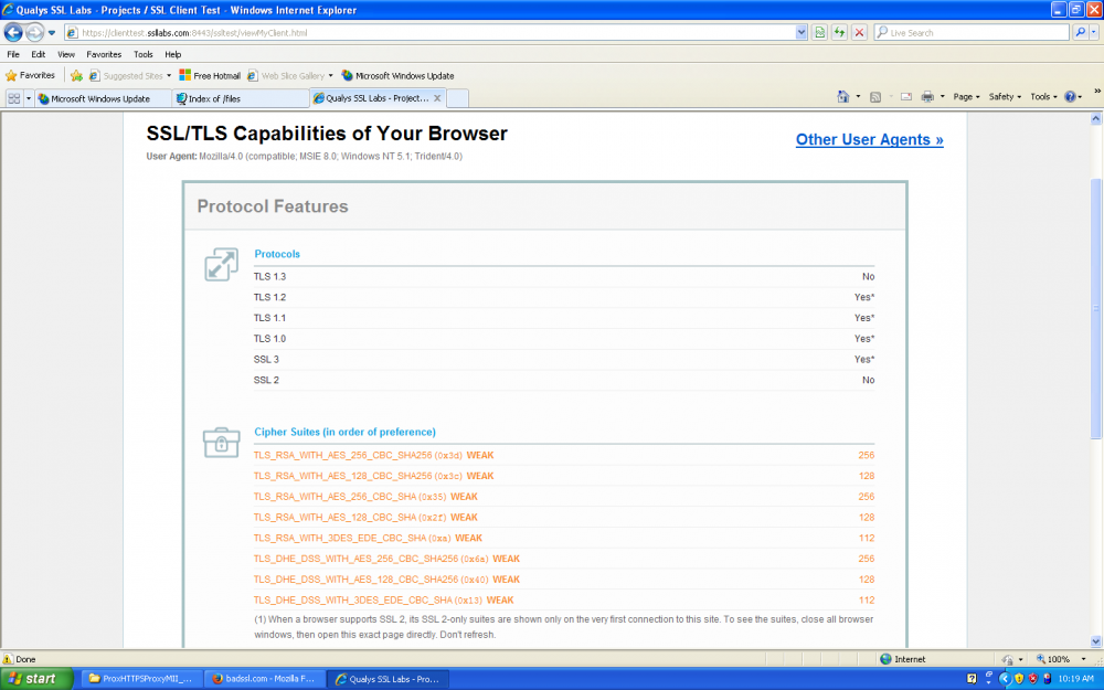

33 minutes ago, xpandvistafan said:
Haben Sie das fehlende Update gefunden? Dies sind meine SSL-Testergebnisse für IE 8 mit TLS 1.2-Unterstützung.

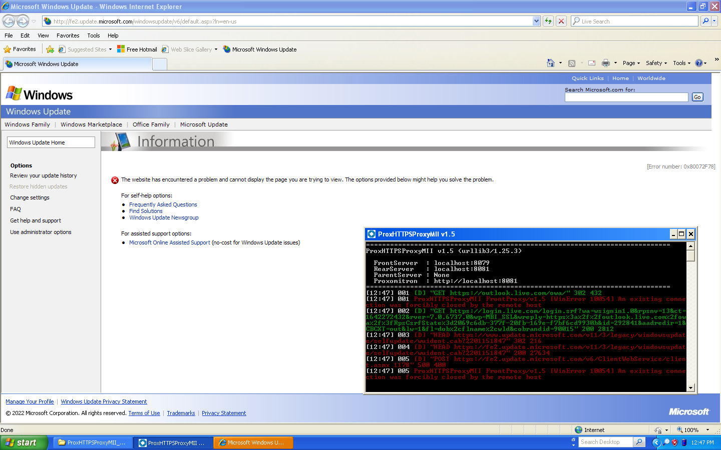

44 minutes ago, xpandvistafan said:
Still does not work. Same 500 error.
