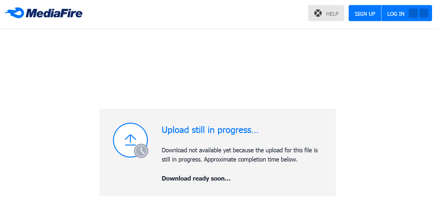

Mathwiz Posted May 26, 2019 Posted May 26, 2019 What the.... (I tried re-enabling service workers; didn't help)
looking4awayout Posted May 26, 2019 Author Posted May 26, 2019 (edited) 13 hours ago, Mathwiz said: What the.... (I tried re-enabling service workers; didn't help) Please re-download it! I have re-released the patch with the Service Workers enabled. You can find it in the main page. Yesterday I tried to upload a test file of 1KB, and after enabling service workers, Mediafire started working again. It might be a problem with the site. EDIT: Mediafire uploads successfully on my computer with the post-fix UOC Patch. EDIT 2: I have tested the 45 ESR version of the UOC Patch on Seamonkey, and I can confirm it works very well. So now, the UOC Patch for 45ESR based browsers, is Seamonkey friendly! Edited May 26, 2019 by looking4awayout
Mathwiz Posted May 26, 2019 Posted May 26, 2019 (edited) Mediafire is working now. Patch downloaded fine. You're probably right; it was probably a problem with the site that's fixed now. BTW, see this post: ... if for security, you want to "lock down" service workers so they only run on sites like Mediafire that require them. Edited May 26, 2019 by Mathwiz 1
looking4awayout Posted May 26, 2019 Author Posted May 26, 2019 (edited) 1 hour ago, Mathwiz said: Mediafire is working now. Patch downloaded fine. You're probably right; it was probably a problem with the site that's fixed now. BTW, see this post: if for security, you want to "lock down" service workers so they only run on sites like Mediafire that require them. I would like to find a way to disable service workers while "filtering" the sites that need them... I will investigate it once I have enough time to delve deep in the patch. Meanwhile, I have released a new version, to fix some bugs. The archive name is the same, "2a", but there are some minor improvements under the hood. As always, please update and let me know if things run better. Edited May 26, 2019 by looking4awayout

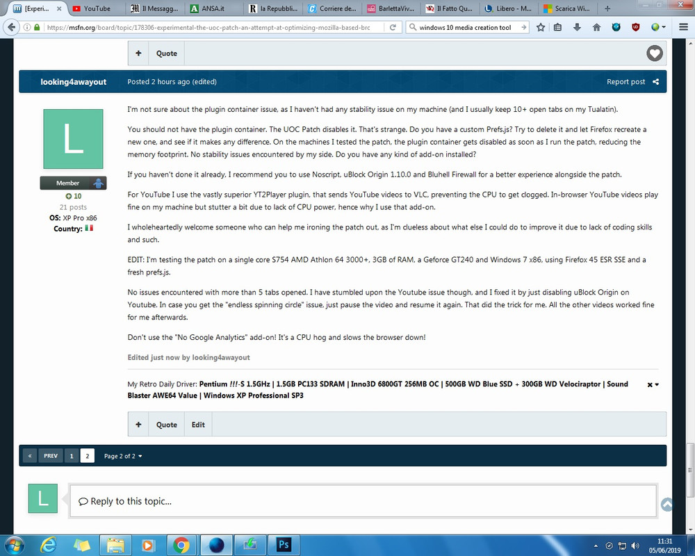

looking4awayout Posted June 5, 2019 Author Posted June 5, 2019 (edited) I'm not sure about the plugin container issue, as I haven't had any stability issue on my machine (and I usually keep 10+ open tabs on my Tualatin). You should not have the plugin container. The UOC Patch disables it. That's strange. Do you have a custom Prefs.js? Try to delete it and let Firefox recreate a new one, and see if it makes any difference. On the machines I tested the patch, the plugin container gets disabled as soon as I run the patch, reducing the memory footprint. No stability issues encountered by my side. Do you have any kind of add-on installed? If you haven't done it already, I recommend you to use Noscript, uBlock Origin 1.10.0 and Bluhell Firewall for a better experience alongside the patch. For YouTube I use the vastly superior YT2Player plugin, that sends YouTube videos to VLC, preventing the CPU to get clogged. In-browser YouTube videos play fine on my machine but stutter a bit due to lack of CPU power, hence why I use that add-on. I wholeheartedly welcome someone who can help me ironing the patch out, as I'm clueless about what else I could do to improve it due to lack of coding skills and such. EDIT: I'm testing the patch on a single core S754 AMD Athlon 64 3000+, 3GB of RAM, a Geforce GT240 and Windows 7 x86, using Firefox 45 ESR SSE and a fresh prefs.js. No issues encountered with more than 5 tabs opened. I have stumbled upon the Youtube issue though, and I fixed it by just disabling uBlock Origin on Youtube. In case you get the "endless spinning circle" issue, just pause the video and resume it again. That did the trick for me. All the other videos worked fine for me afterwards. Don't use the "No Google Analytics" add-on! It's a CPU hog and slows the browser down! Edited June 5, 2019 by looking4awayout

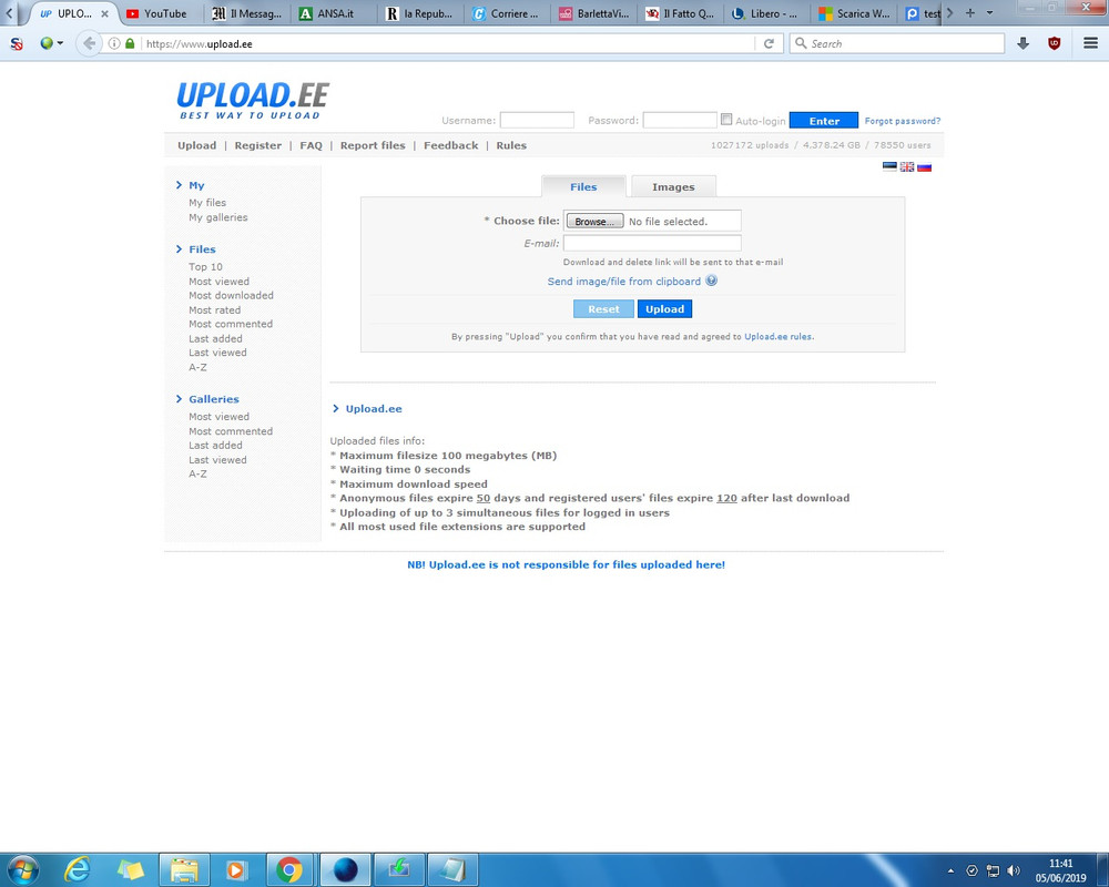

Vistaboy Posted June 5, 2019 Posted June 5, 2019 In C:\Programs\firefox\defaults\pref i have only channel-prefs.js and UOC_Patch45.js, no custom prefs.js. I use only ublock but just for isolating issue/testing purpose on plugin-container try to open this from your FF45SSEpatched browser and see what happens. I can open it from Chrome but in FF45 everything hang up.
looking4awayout Posted June 5, 2019 Author Posted June 5, 2019 (edited) 24 minutes ago, Vistaboy said: In C:\Programs\firefox\defaults\pref i have only channel-prefs.js and UOC_Patch45.js, no custom prefs.js. I use only ublock but just for isolating issue/testing purpose on plugin-container try to open this from your FF45SSEpatched browser and see what happens. I can open it from Chrome but in FF45 everything hang up. Oh no no! You can find your Prefs.js file in your profile folder. If you have XP go to "C:\Documents and Settings\(Your Username)\Application Data\Mozilla\Firefox\Profiles\(Your Profile folder)" In case of Vista, go to "%Appdata%\Roaming\Mozilla\Firefox\Profiles\(Your Profile folder)" EDIT: Just tried the page you linked. No issue by my side, except I had to whitelist the site in Noscript. No lockup. To put additional strain on the A64, I'm also making a Windows 10 USB drive through the Media Creation tool. Edited June 5, 2019 by looking4awayout
