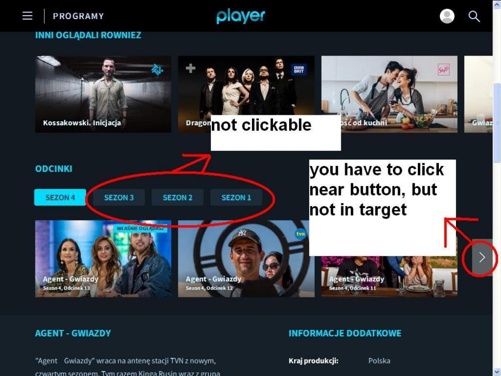

Seba21 Posted June 1, 2019 Posted June 1, 2019 (edited) Instagram stories videos now working again on 2019.05.31 (32-bit) version But blue buttons on player.pl still do not work from February https://player.pl/programy-online/agent---gwiazdy-odcinki,4305 Edited June 1, 2019 by Seba21

Mathwiz Posted June 2, 2019 Posted June 2, 2019 6 hours ago, Seba21 said: Instagram stories videos now working again on 2019.05.31 (32-bit) version But blue buttons on player.pl still do not work from February https://player.pl/programy-online/agent---gwiazdy-odcinki,4305 Thanks for the link, and good to hear Instagram is working for you again. Do you know the precise version from February that works (with the next version not working)? If so, we can study the change log and see if we can find the change that broke that site. Then we might be able to figure a workaround, or even revert the change. That's how we fixed another Instagram bug a few months ago.
VistaLover Posted June 2, 2019 Posted June 2, 2019 35 minutes ago, Mathwiz said: That's how we fixed another Instagram bug a few months ago. Cheers , you've come pretty close to the resolution of the reported issue; in fact, it's "instagram #2" deja-vu: the type of Javascript code to be sent to the client (browser) by the player.pl video portal is being determined by UA-sniffing; their poorly written site (which, by the way, is infested with third party scripts ) does not like any of the three user-selectable UA strings (testing with New Moon 28.6.0a1) : Native: Mozilla/5.0 (Windows NT 6.0; rv:60.9) Goanna/4.2 PaleMoon/28.6.0a1 Gecko compat: Mozilla/5.0 (Windows NT 6.0; rv:60.9) Gecko/20100101 Goanna/4.2 PaleMoon/28.6.0a1 Firefox compat: Mozilla/5.0 (Windows NT 6.1; rv:60.9) Gecko/20100101 Goanna/4.2 Firefox/60.9 PaleMoon/28.6.0a1 The JS code sent with any of the above UA selections renders the SEZON buttons for the Odcinki series inoperable (non-clickable); further troubleshooting reveals that that's because UXP can't handle the Firefox Quantum 60.9-specific code it's being fed ; a pure Firefox ESR 52.9 SSUAO for player.pl will make the SEZON buttons operable again, but when you first load the site you'll get a prompt to upgrade to a more recent (and supported) browser brand/version; you can dismiss that prompt and, hopefully, proceed to view... However, I've found that to make those buttons work as expected but not get nagged at (for running an older, unsupported, browser), one should use the "Firefox compat" string modified to report a Fx 52.9 version: general.useragent.override.player.pl;Mozilla/5.0 (Windows NT 6.1; rv:52.9) Gecko/20100101 Goanna/4.2 Firefox/52.9 PaleMoon/28.6.0a1 @Seba21 Please understand that your problem site is specific to Polish speakers and that most of its media content is geo-fenced for non-Polish IPs ; so it's quite difficult for members here that don't understand Polish to navigate that site, troubleshoot it and offer advice/solutions Be that as it may, I believe your issues can be cured by creating (in either New Moon 28 or Serpent 52) a Site-Specific-User-Agent-Override (SSUAO) for player.pl ; that procedure has been explained numerous times in this and other threads: Load about:config in a tab, promise to be careful Right-click in an empty space and choose to create a new "string" preference - a pop-up will be displayed As name of the pref, input general.useragent.override.player.pl and click OK - second pop-up will be displayed As value of the pref, input Mozilla/5.0 (Windows NT 6.1; rv:52.9) Gecko/20100101 Goanna/4.2 Firefox/52.9 PaleMoon/28.6.0a1 and click OK Close the about:config tab Reload the player.pl tab ... you should then be able to use your SEZON buttons...
