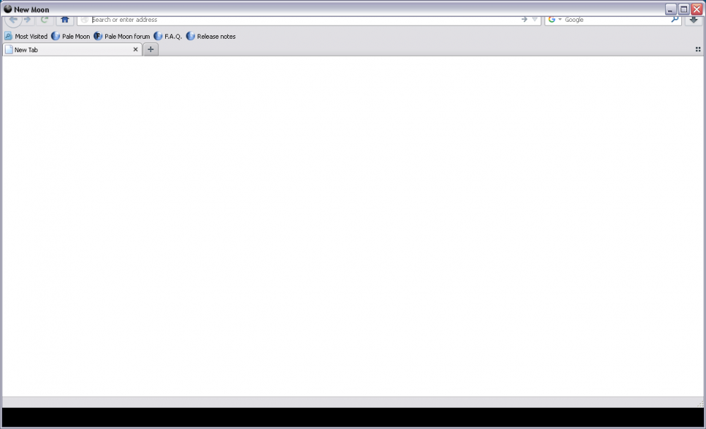

Regarding OpenGL, I was wondering if the op can have a look at this:
This is the problem when OpenGL is selected.  The entire application seems to be shifted "up" a bit (for lack of a better explanation).  A mouse click also reflects this (where you get the actual click on top of where you click).

I have no idea about OpenGL acceleration glitch, you may try Feodor2 or even official build (in newer windows of course) to see if OpenGL acceleration is still having glitch. If so, please file a bug to Feodor2 or official depending which build you tested. Thank you.

@dv_2, I have the exact same issue with OpenGL, but I haven't tried it with official Palemoon on Windows 7 or anything like that yet.
