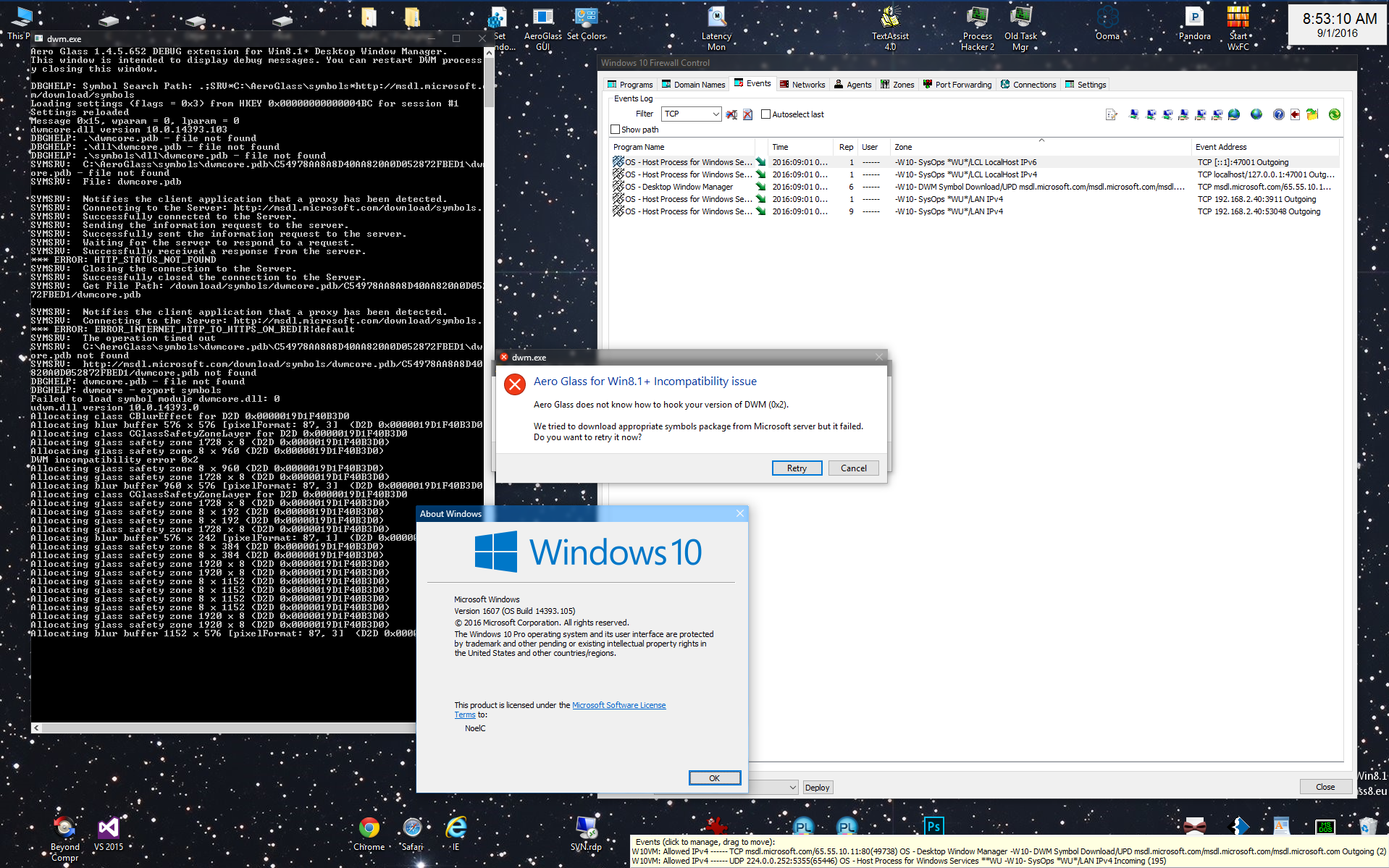

Here came a new Windows update KB3176938, and once again, Aero Glass is confused about new dwmcore.dll, and fails to download symbols. Cancelling DWM incompatibility error dialog and letting it work with current knowledge seems to be working at first glance.
Edited by UCyborg
I see the same thing.  The error message *** ERROR: HTTP_STATUS_NOT_FOUND is being returned from the server upon attempt to download a new dwmcore.pdb.
Usually what happens in these cases, where it seems to work for some and not others is that another try in the future (e.g., because of a reboot or restart of DWM.exe) ultimately nets a successful symbol file download.
For what it's worth, right at this time I'm waiting for a set of symbols to download into Visual Studio so that I can do some debugging on something completely unrelated to Aero Glass and Win 10, and that's taking an age.  Microsoft's servers are probably overloaded.
-Noel
I just did another reboot to see if the incompatibility window came up but still didn't get one, the dwm.exe cmd window does show that dwmcore.pdb cant be found but I am not seeing any other windows aside from the cmd window.

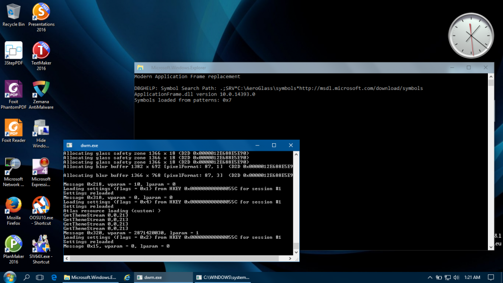

I'm finally on the Anniversary Update. Before installing it (over 1511), I took the recommended precautions of disabling aerohost.exe in Task Scheduler and moving the contents of the Aero Glass folder to a different location.
Once the AU was done setting itself up, I downloaded the new Aero Glass experimental build and extracted the files to the Aero Glass folder. Two windows are being opened and I'm hoping that the experts here can describe what they are:
I am especially curious about that "Microsoft.Windows.Explorer" window, it doesn't look like any Windows Explorer window I've ever seen. And, in any case, I thought Microsoft had renamed Windows Explorer to File Explorer?
Aside from that, what do the contents we see in the screenshot mean?
--JorgeA
It's the debug windowses, as this version is debug one. One is for main process, aerohost, and the other one is for modern frame transparency for apps. Do a virtual desktop, then move them there.
