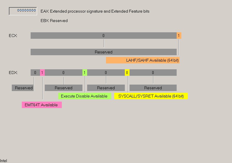

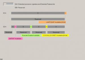

When I finally worked out how to run the thing, CPUID Explorer didn't actually mention NX specifically anywhere in its analysis results, but in one tab "CPUID(0x80000001)" in the "EDX" section it does display "Execute Disable Available" in green with a green "1" above it.
Is that it?
post-84253-0-94973500-1413979225_thumb.j
Sounds confirmed then, that's good!
