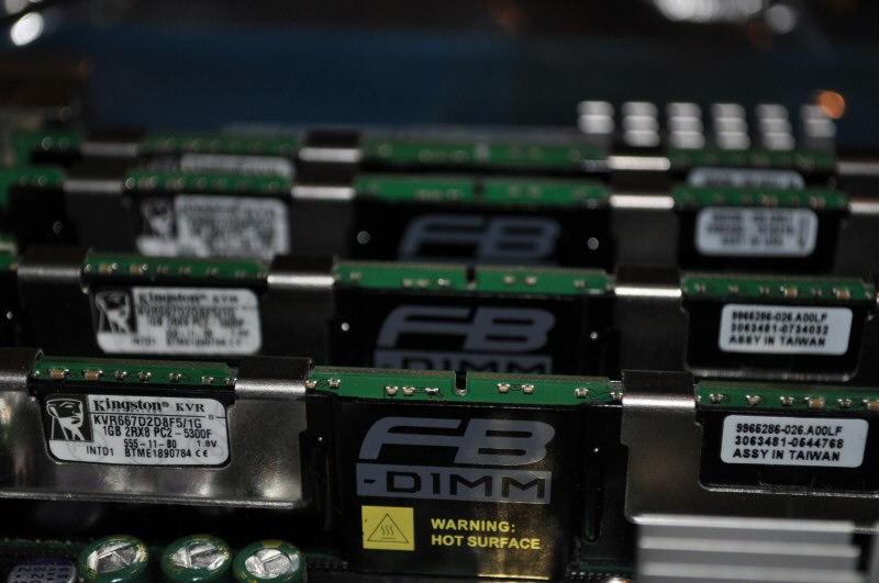

The DIMMs do have some sort of metal heatsinks on them.
post-84253-0-02052300-1413826304_thumb.j
These are the original 1GB DIMMs that came with the motherboard, but the present 4GB ones look physically the same.
When they say "hot surface" they're not kidding!
